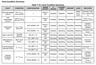

    (4) Is there a level (priority) set within the device for the FAULT condition?
    No priority, whatever happens first.  Table 7-10. Fault Condition Summary you posted is a great reference for what happens during each condition.

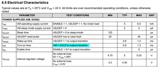

    (5-1) When power is applied to the board, is it correct that the FAULT signal is Hi during the period when the VM of the device is at a low voltage?
    The device is powered by VM, so when VM < 4.5V the device will be off and all pins will likely be Hi-Z unless they have an external pull up/down.  Given nFAULT should have an external pull-up resistor, yes, nFAULT would read HIGH to a MCU during this time as long as the VCC nFAULT pullup resistor connected to is high.  I think I am not understanding your question correctly?

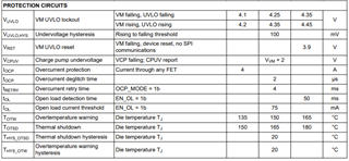

    (5-2) ( When power is applied to the board) If the UVLO bit is not cleared, it remains latched to Hi. So clear processing is required when the board receives power. Is my understanding correct?
    UVLO only is enabled after the device "boots up", so UVLO bit does not need to be cleared when device is powered up.

  • Hey Takemura-san,
    Do not need to resend parameters after CLR_FLT or nSLEEP pulse.  You would only need to resent parameters if the supply voltage VM dipped below VRST UVLO reset as shown in Figure 7-20. Supply Voltage Ramp Profile
