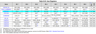

1. For below box marked in blue, nFault=L at normal mode and GND short condition, nFault=H at open fault condition and VM short condition. How to distinguish them? I don't see any register show OLP diagnostics status.
2. Below table only indicates the diagnostic status of active mode, right?
    The difference is whether the user set up ROLP as a pull up or pull-down.  Based on this setup you can know whether your result is indicating short or open.
    Yes, that register reports the status of those conditions
