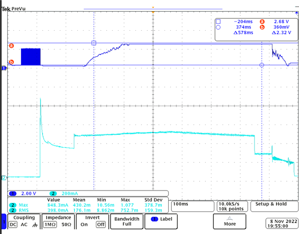

    The image below shows the TRQ-CNT pin voltage when the make 1 motor is running freely.
    In the beginning and end we are seeing a rise and fall in TRQ-CNT because of our acceleration and deceleration profiles. I am not detecting stall in these regions. I am detecting stall once the TRQ-CNT voltage stabiles to 2.5V. Now if the TRQ-CNT falls below 1.8V, I am considering it as stall. This algorithm works fine for stall detection in make 1 motor.

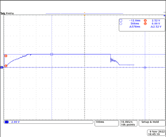

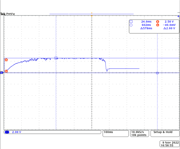

    The images below shows the TRQ-CNT pin voltage when the make 2 motor is running freely.
    In the above image, I dont see any abnormalities in TRQ-CNT and the run was not detected to be stalled.

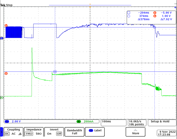

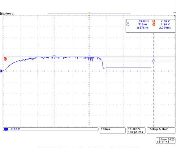

    When running the same motor again, sometimes we see a TRQ-CNT profile something like below.
    Here we saw the TRQ-CNT dip, even though there was not load on the motor. Both the 2nd and 3rd image were captured on the same motor under same conditions.
    Sometimes I have observed the TRQ-CNT dip to even below 1V when there was not load on the motor.
    We wanted to know what is causing the TRQ-CNT to dip even when there is no load.
    We are getting a lot of false positive stall detections due to this.

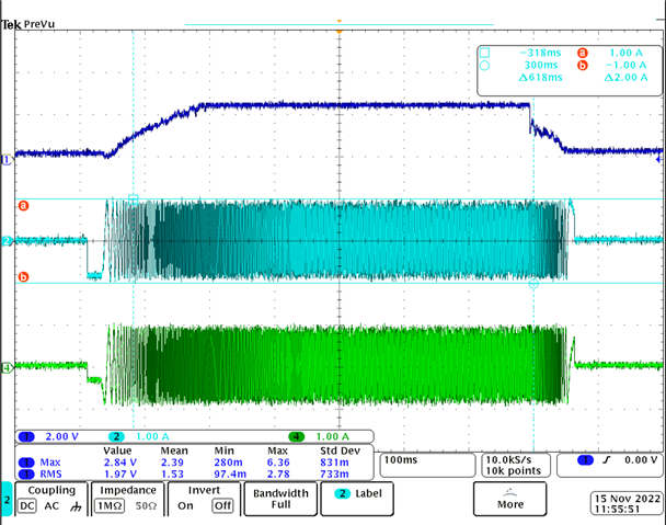

    Please find the waveforms below.

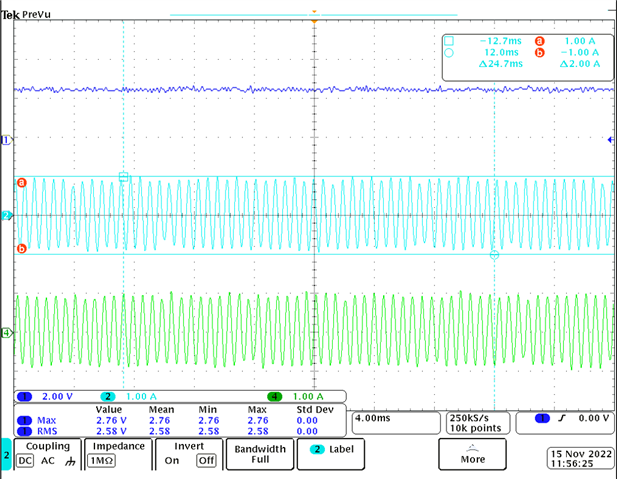

    Make 1 Motor:
    Channel 1 is TRQ-CNT, Channel 2 and 4 are current through the 2 motor coils.
    Channel 1- TRQ-CNT, Channel 2 - System total input current

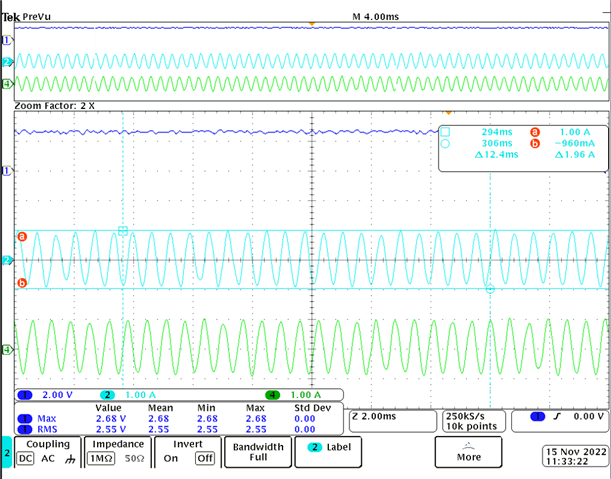

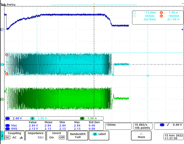

    Make 2 motor:
    Channel 1- TRQ-CNT, Channel 4 - System total input current

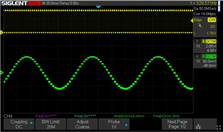

    Thank you for capturing and sending us these waveforms. Unfortunately I'm unable to judge if the current regulation is happening as desired at the microstep level. I'd like to have the current waveforms with more detail. Below is an example. Would be even better if further scaled up like to full screen scale showing one or two full cycles peak to peak with each microstep having enough information to show the current regulation ripples. I did notice the current waveform peaks are not stable. Is the VM voltage stable and with minimum ripple while the motor is running at the target speed? There seem to be occasional dips in current waveform peak-to-peak values especially with the motor 2.
    Regards, Murugavel

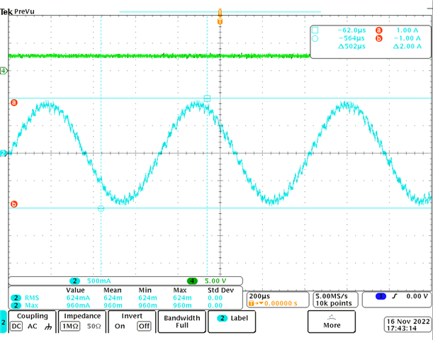

    Here is the better waveform of make 1 motor current:

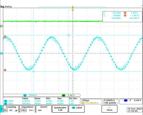

    Make 2 motor:
    I am using a constant power supply of 24V as supply voltage. The same power supply was used when running make 1 and make 2 motors.

    We reviewed the waveforms and unable to find anything unusual electrically. We have seen in the past some stepper motors result with noisy torque counts based on the mechanical precision of the poles construction. We wanted to rule out electrical issues by looking at the comparative parameters and the current waveforms, appreciate you providing us all those details. It appears the noise is likely due to the mechanical properties of motor 2. One suggestion we have is to use an RC low pass filter to smooth out the noise on this torque count output. Alternately you could also implement a moving average filter in the MCU on the ADC converted digital samples of the torque count, like a 32, 64 or 128 samples moving average. This would result in a smoother profile of the torque count regardless of the noise. Having an RC filter would be the easiest to manage but would require hardware change. A firmware moving average filter would not require any hardware modification. Thanks.
