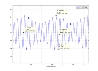

We are using the MCT8316Z controller to drive a small motor from 200RPM up to 6000RPM. The requirement for the control loop is to adjust the PWM into the MCT8316Z to run at a fixed rotational speed that is determined by various system parameters. At low speeds (say 200RPM) we have observed higher than expected variations in the rotational speed even when we run in open loop mode with a fixed PWM setting. There is about +/-5% variation that has a frequency that is a multiple of the rotational speed. The plot below shows the control loop attempting to smooth out the ripple, but really is not able to have any effect at that frequency. I would like help to if there are any of the strap settings for the controller that would be recommended to improve the performance.
  • Hi Randy,
    There are 3 waveforms on the pic, without any introduction, I have no idea what they are. Is the middle one the motor speed?
    Brian
  • Do you use FGOUT for speed feedback -- what is the value for FGOUT_SEL? Or do you use encoder?
    At 200rpm or 3.3 rev per second is fairly slow speed, and so it is more challenge to control it at precise speed, and it all depends on the gain setting for P and I in the PID loop. How do you measure the speed feedback -- frequency or period of the pulses?
    P.S. How many pole-pair for the motor? High poles will give high FGOUT resolution for better speed control.
    At low speed, measured period is better than measured frequency for speed feedback.
    Brian
  • Hi Brian,
    The control loop uses optical encoders with 242 encoder stripes per revolution. The plot shown has a legend but is hard to see - the RPM is the red waveform that has the more sinusoidal looking ripple waveform about 200RPM. The motor is a Maxon EC 20 series 5 watt BLDC device with 4 pole pairs.
    This sounds like you don't have enough gain in PID. What happened when increase more gain?

    The motor is a facet optical wheel that directs small laser dots onto a skin surface. The good news is that the fine pitched optical encoder allows for the laser to be able to fire at the correct location on the wheel. We calculate the width of the laser fire pulse based on the nominal wheel speed that is set. At the plus peak in Motor RPM, the available facet time is 5% less than expected and we can start to bump into the edges of the facets with the laser beam. The control loop does a good job of keeping the average speed very accurate (within 1% or so), but we would like the ripple to be as small as possible. We had a legacy product that actually did a better job than this at providing low ripple over full range (200RPM to 6000RPM), but the controller is end of life and the motor had a higher number of poles that most likely helped out. We may be able to live with +/-5% if we cannot do better, but would like to see what else can be done.

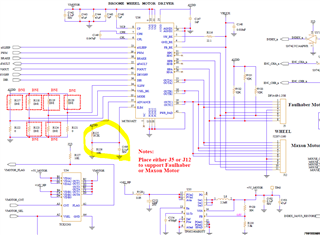

    One experiment was to add about 60 grams of extra weight to the wheel (currently only 10grams). This resulted in a significant reduction in the ripple. I think our relatively low rotational inertia causes a significant amount of ripple as the windings pass by each of the poles (ie back emf). We cannot easily add so much extra weight to the wheel to fix this, but was a helpful insight. The next approach would be to see if we can speed up the response of the MCT8316 forcing function as it receives a commanded change in the input PWM. The ripple frequency is only 30hz - probably would want the control loop to be able to respond within a millisecond or so to be able to dampen out the ripple. I have attached schematic and better plot of ripple - can I speed up response by reducing capacitor on ILIM pin?
  • can I speed up response by reducing capacitor on ILIM pin?
    No. The cap is a filter for the voltage divider to set the current limit -- a DC level; it has nothing to do with the motor response to PWM change.
