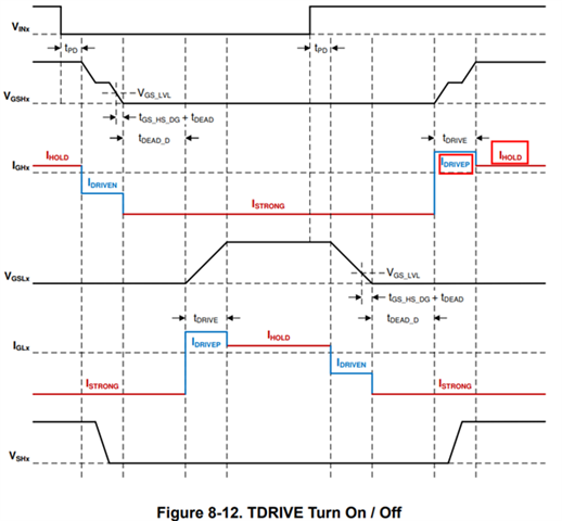

Dear expert,
Customer measured Vgs as below green curve. There is a voltage drop.
Does it caused by Idrvp switch to Ihold? Is it normal?
Dear expert,
