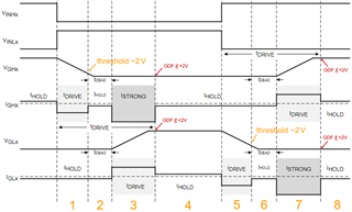

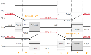

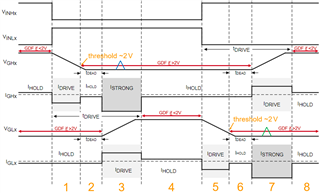

referring to the GDF question regarding DRV8714-Q1, I would like to verify when the GDF can be triggered using DRV832x.
Is it right that the GDF can be triggered always, when the switching operation of the observed FET is finished as annotated in the diagram below?
This would mean, that a voltage peak greater than 2V (threshold) can lead to a GDF (blue and greed peak).
Thank you in advance
