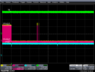

DRV Damage Effect: Gate-Source short is present on DRV output pins GLC(pin18)-to-SPC(pin19) ~4 ohms. MOS-FETs are not affected by the DRV damage.
Test Condition: VM = 15V during the test. VDRAIN drops from 25V to 0V. Motor Phase Currents with 0RPM / PH_U=+5A / PH_V=-2.5A / PH_W=-2.5A.
When VDRAIN reaches 17V, COAST bit is set = 1 to force the FETs in Hi-Z, since this is the threshold level of Lower Operating Motor Range.
1.Could this COST=1 request create permanent damages on internal Charge Pump having VDRAIN dropping to 0V?
2.Just after COST=1 request, the input PWMs are set to 50%. Can you confirm that COST bit overwrites the PWM requests and this can't lead to an Charge Pump damage?
3. In case ENABLE is toggled low, having PWM inputs set to 50%. Could this active PWM present during twake lead to a permanent damage of the internal Charge Pumps.

  • Hello Akshay,
    These variables are a mix of DRV physical signals and SW variables related to motor control disabling phase.
    VDRAIN = Blue Color Waveform
    Motor Phase U Current = Yellow Waveform
    Motor Phase V Current = Green Waveform
    PWM Duty Cycle (phase U) = RED Waveform
    As mentioned initially Test Condition: VM = 15V during the test. VDRAIN drops from 25V to 0V. Motor Phase Currents with 0RPM / PH_U=+5A / PH_V=-2.5A / PH_W=-2.5A.
    When VDRAIN reaches 17V (BLUE trace), COAST bit is set = 1 to force the FETs in Hi-Z, since this is the threshold level of Lower Operating Motor Range.
    1.Could this COST=1 request create permanent damages on internal Charge Pump having VDRAIN dropping to 0V? (while VM = 15 V remains)
    3. In case ENABLE pin is toggled low - for reconfiguration after VDRAIN gets back to normal levels, having PWM inputs set to 50%. Could this active PWM present during twake = 1ms, lead to a permanent damage of the internal Charge Pumps?

  • To Summaries the Problem and answer the questions from Dang Brian:
    Device affected DRV8353SMRTAT in 40-pins VWQFN package.
    DRV Damage Effect: Gate-Source short is present on DRV output pins GLC(pin18)-to-SPC(pin19) ~4.7 Ω. MOS-FETs are not affected by the DRV damage. The short is present with board unpowered. It doesn't matter if VDRAIN is turned off (disconnected), or ENABLE line is low, the 4.7 Ω is present all the time.
    Test Condition that leaded to this Damage:
    In normal operation device works fine, even with relatively large Motor Phase Currents +/-20A.
    The problem occurred during system Power Supply Interruption – 24V drops to 0A (tfall=1ms), and stays at 0V for 120ms, then returns to 24V (trise=1ms)
    The IDRIVEx registers setting are set as following:
    IDRIVEP_LS = 0010b = 100mA & IDRIVEN_LS = 0010b = 200mA
    IDRIVEP_HS = 0011b = 150mA & IDRIVEN_HS = 0010b = 200mA
    Driven MOS-FETs: IAUT150N10S5N035ATMA1
    VM = 15V remains constant during the test. VDRAIN drops from 24V to 0V. Motor Phase Currents with 0RPM / PH_U=+5A / PH_V=-2.5A / PH_W=-2.5A.
    The official test condition is a voltage drop from 17V to 0V, but actually the initial voltage doesn't matter that much.
    Software Control:
    When VDRAIN reaches 17V, COAST bit is set = 1 to force the FETs in Hi-Z, since this is the lower threshold level of System Operating Range.
    Just after the COAST bit set to 1, PWM DutyCycle is set to 50%. As can be seen in the next plot, DRV goes in UV caused by VDRAIN 6.4V which is OK (confirmed by Status Registers readings)
    For the attached plot, I've added the measurement unit for each signal. PWM is in % Duty Cycle, so we see that it tries to compensate the VDRAIN voltage drop until COST bit is set to 1, by increasing with 2%. Then is permanently set to 50%.

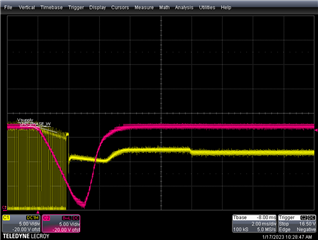

    4) I also want to check how fast the coast bit is being set. Could you provide waveform of Vdrain, GLA, GLB and GLC as you power down Vdrain and set coast bit at 17V?

    NFAULT is activated, when VDRAIN reaches about 6.4V. In the same moment, some flags are set in the Status Registers 1 & 2 (please check the updated picture from original post).
    On the waform, nFAULT should be an active low signal -- low means fault and high means normal. Then why nFault is low when Vdrain is above 20V (the waveform with label says "SW state" meaning the graph waveform represents the software status bit value, not the nFault output signal? (But then the graph seems to have slow rise time, which cannot be a status bit that has a slow rise time. I'm so confused).
    I think the driver chip was damaged due to all output were high-Z at relatively high motor speed with high BEMF that feedback to the driver. Why to coast instead of brake which is safer with 3 lower FETs turned on?
    Brian

    4) VDRAIN is P28V_FLT trace is some pictures from attached Excel file. As can be observed in the first 7 pictures VDRAIN is ~15V when COAST is set.

  • Hello Brian,
    In the waveform plot FAULT is a Software state, meaning that when HW NFAULT was activated = Low in our Software it goes to High.
    Yes, you are right the graph was quire low resolution ~1ms, this is a capture of parameters from SW, to better understand the test sequence. Please have a look into the attached Excel file for HW plots, captured with the Oscilloscope.
    The test was performed without the Motor. Only Static Loads, L and R. So there is no rotation, Speed is = 0 RPM, angle is fixed to have +5A on phase U / -2.5A on the other two phases.

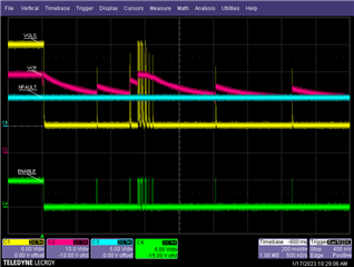

  • Hello Akshay,
    Before sharing the schematic, I would like to mention that was already reviewed by TI together with the layout a few years ago, so there is a low probability to find something new. Especially since in normal operation, everything works fine - it's just the Supply Interruption that causes these problems.
    We did several investigations these days, and we thing the problem is related to the initialization phase when ENABLE line is released.
    In the following plots you will notice that ENABLE is not stable. Can you confirm that this kind of oscillation could damage the DRV. It can be observed also that VGLS and VCP didn't reached the nominal level, but the input PWM demand is present, requiring to control the external FETs(in some cases).
    Can you provide your observation, focusing on the unstable ENABLE line and the influence on the DRV chip internal supply initialization. We assume at some point the VGLS linear regulators could be affected, but we don't have a clear overview of the internal architecture. Also VCP charge pump will demand some inrush current from VM that could lead to some overheat ... these are just assumption since we don't know how the chip will handle the fast ENABLE toggling.

  • Hi Dragos,
    Can you confirm if this 50% PWM during initialization (including twake=1ms), could create a permanent damage on the device, due to operation with DEFAULT Register Settings
    Whenever the device experiences some kind of under-voltage or the device gets put into sleep mode, the internal drivers of the device get put into a low power mode resulting in all of the device settings getting put into their default mode. So whenever the device experiences an under-voltage, or wakes up from sleep, you will need to reconfigure your device's settings before applying any PWMs because the gate drive current operating at those levels could cause a violation of the max rating on the GLx pins or on the SHx pins.
