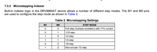

Hi, I've been using the DRV8886ATEVM in a stepper motor testbench. Unfortunately, it appears to have stopped having the ability to run in full step mode. When I set it to run in full step, it runs in 1/8 step. I am using the app that was designed to run it. Any ideas?

    I wonder if the connection to the "M0" pin has somehow come loose.
    If M0 pin is HIZ, you will be in 1/8 step.  If all you desire is full step, just take a blue wire and connect this pin to GND.
