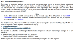

2. FAULT# Viewing pictures can be locked, how can I unlock it?

    2. Please refer datasheet 8.3.4 Protection and Diagnostics. In SPI variant, it is cleared by CLR_FLT command or SLEEP command through the nSLEEP pin. for HW variant, nSLEEP pin or power cycle.
