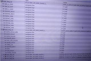

The customer uses an open source project's F28069M Evaluation Board+8305 scheme to control the motor, the firmware is also provided in the original project, and the motor runs smoothly and without noise.This project was followed by the design of an integrated PCB board, known as Micro driver, using the F28069M chip + 8305, which is currently the V2 version.
The same firmware and algorithm are used by the customer to entrust the PCB patch manufacturer with the circuit diagram, and the motor makes a sharp noise and is stuck. As shown in the following video:

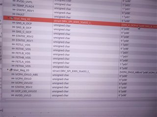

Read back the status of the 8305 through SPI. It is assumed that the nFault issue is reported on the 8305. Here is the value of register 2 of the motor read back:
The circuit diagram for the PCB board is as follows:

    What caught my eye is the registers. I noticed you have a PVDD under-voltage and VDS overcurrent on some of the phases. What voltage were you supplying to the driver?

    Trying to get the info you required. BTW, PVDD_UVLO2 of register 3 is set, will this have any impact on the issue?

  • BTW, PVDD_UVLO2 of register 3 is set, will this have any impact on the issue?
    I think the root cause is the over-current at the FETS: high side C + low-side B + low-side A. These FETs are having high current and the driver detects this. Since the FETs are connected to PVDD supply, and so the FET high current pulled PVDD lower than 4.4V (min threshold) and triggered the PVDD_UVLO2.
