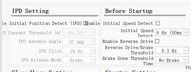

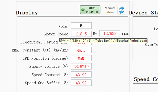

    Still two questions. 1. As showed in below figure, the motor speed RPM equals to (120x10^6)*(poles box)/(Electrical Period box), I am little confused about the formula. Could you please help me explain how to get this formula? In my view, motor speed is equal to 60f/P.  2. As below figure, What will happen if IPD and ISD are not set? If it must be set, what value do you suggest?
    Many thanks!
    BRs, Sherman

  • Hi Sherman,
    The GUI screenshots that you shared are from DRV109xx EVM but we have been discussing about MCF8316A in our earlier posts. Can you clarify?
    You are absolutely right! The equation in the DRV109xx GUI is incorrect. Motor speed in RPM should be 60f/P.
    If IPD is not set, device chooses "Align" as the motor startup method. If you select IPD, device will choose IPD as the motor startup method. IPD is chosen when you do not wish the motor to rotate in opposite direction during startup. More details about motor startup in  section 8.4.3.5 (Motor Initialization) in DRV10987 datasheet. You can start with the default values programmed in the device.
    ISD is initial speed detect. The ISD function is used to identify the initial condition of the motor. If the function is disabled, the DRV10987 device does not perform the initial speed detect function and treats the motor as if it is stationary. If the function is enabled, the speed and position information measured during ISD are used to initialize the drive state of the device, which can transition directly into closed loop (or open loop if motor speed is not sufficient for closed loop operation) state without needing to stop the motor. More details about ISD in section 8.4.3.1 in DRV10987 datasheetYou can start with the default values programmed in the device.
    Please refer to the DRV10987 tuning guide and "DRV10983x, DRV10975x, and DRV10987 IPD Tuning Guide" for more details related to tune IPD and ISD.
    Vishnu
