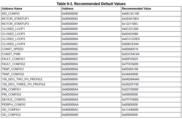

I have an MCT8316A motor driver that I'm controlling with a PIC32MM microcontroller over I2C. I'm trying to write the EEPROM with the default configuration that appears in the datasheet. The configuration is the following:
To achieve that, I'm writing each register as detailed in section "8.6.2 I2C Serial Interface" of the datasheet. For example, for writing the shadow register corresponding to ISD_CONFIG with the data 0x6EC4C100 I'm sending the following over I2C:

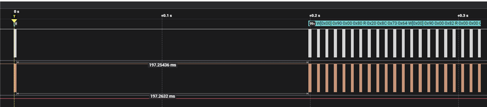

In order to read the EEPROM I write the value 0x40000000 into register 0x0000E6. This is the I2C transaction corresponding to that command:
After that, I wait for 200ms and then I start reading each of the shadow registers.

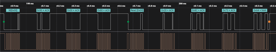

For reading each of the shadow registers I execute the following I2C transaction (example for reading the ISD_CONFIG register):
As you can see from this example, the value that I'm reading from the ISD_CONFIG register is 0x64738C20, and the expected value was 0x6EC4C100. So that means that the EEPROM is not being written with the shadow registers I configured.
