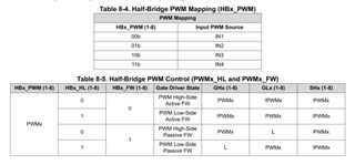

Assume two half-bridges are used to set the PWM complementary outputs as follows:
Half Bridge 1 setup: Set HB1_PWM to 00B according to Table 8-4 below, that is, Input PWM Source for half Bridge 1 is IN1, and then set HB1_HL to 0 according to Table 8-5 below. HB1_FW is 0.
Half-bridge 2 setup: Based on Table 8-4 below, set HB2_PWM to 00B as well, that is, the Input PWM Source for half-bridge 2 is also IN1, and then set HB2_HL to 1 according to Table 8-5 below. HB2_FW is 0.
Based on the settings above:
GH1 of half bridge 1 is PWM1 and GL1 is! PWM1, GH2 of half bridge 2 is! PWM2, GL2 is PWM2. Because the Input PWM Source for half-bridges 1 and 2 are both IN1, so PWM1=PWM2, ! PWM1 =! PWM2.
So can the above setting be considered a complementary output with the PWM set? The Input PWM Source is all IN1, and the timing is guaranteed.
Are the above setup and considerations are possible and correct?

  • Hi Cherry,
    Thank you for your questions.
    Based on your register setting, DRV provide opposite(you said complementally) PWM toggle on GHx/GLx/SHx. It is as written in datasheet. Your setting is correct.
    One more note.
    Your comments "The Input PWM Source is all IN1, and the timing is guaranteed." .
    In real application of gate driver, output toggle timing has some shift/delay by charging/discharging the external FET/Cap etc. Each timing has slightly delay. As a result may have gap ~ micro sec range gap.
    I guess this should not be matter in normal motor/inductive load driving use case.
    regards
