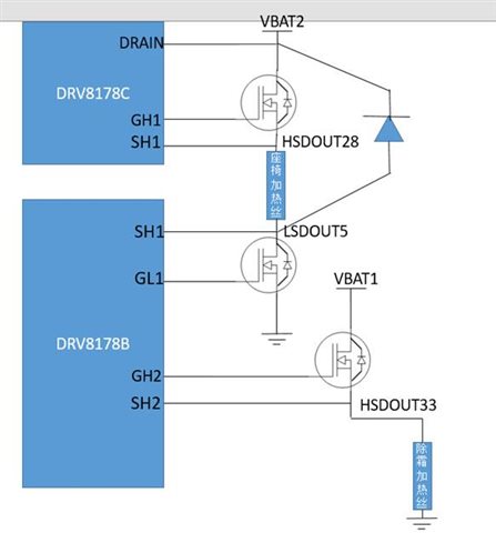

I have two questions:
1. Does voltage at GHx follow SHx voltage? Mean if SH1 is 9V, then GH1 is also 9V for FET OFF status?
2. Can I use below topology below? (Connect SH1 from two different DRV8718 silicon) Between two SH1 is a 1ohm thermal resistor.
