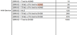

I've been working with DRV8323EVM (HW config) and I noticed this pin configuration:
As you can see the IDRIVE and VDS pins are configured with a 75k pullup and a 75k pulldown at the same time.
I don't see this configuration in the datasheet I only see these 7 possibilities:
What would the EVM configuration be?
Thank you in advance.

  • Hi Pedro,
    The pullup and pulldown on the IDRIVE and VDS pins are a voltage divider as shown below:
    which has a formula of Vout = Vin * R2/(R1+R2), so Vout for IDRIVE and VDS would be equal to 1.65V.
    Looking at table 7.5 Electrical Characteristics under Seven-Level H/W Inputs (IDRIVE, VDS), the Vout calculated would be equivalent to "Input mode 4 voltage" as highlighted above.
    ~Alicia
