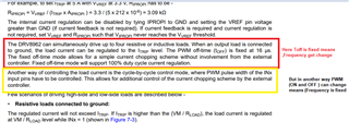

Good Day. Planned to use DRV8962 but is frequency fixed or not? Please confirm. Thank you very much.
Ray Vincent
  • Hi Ray Vincent,
    You are correct. The integrated current regulation loop in the DRV8962 uses fixed tOFF for Itrip current regulation. This alludes to tON being determined by the motor / load characteristics, supply voltage and target current Itrip value. So natively DRV8962 Itrip current regulation is not fixed frequency.
    The "another way" described in the data sheet paragraph you outlined in the yellow box mentions an external current regulation method done by using an external controller, for example one can do a cycle-by-cycle control of the input PWM duty cycle using the IPROPIx information from the driver. The algorithm should be developed and run in the controller (MCU). Yes, this could be using a fixed frequency PWM. Keep in mind the regulation loop should be running in the external controller.
    Regards, Murugavel

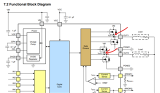

  • Hi Pooja,
    I'll provide my answers in the same order as your queries in the image snippet you sent. It would be helpful if you could type in your questions directly instead of the image snippet just so I can cut and paste certain portions for context and provide our responses.
    1.  You are correct. With resistive load internal regulation will not work because of the current rise time which will be almost immediate resulting in narrow current spikes during every regulation cycle. If you disable current regulation by connecting IPROPIx to ground then you won't be able to get current feedback for that channel. Hence I mentioned previously to set VREF at maximum and choose the IPROPIx resistor such that current will never reach the trip threshold. You can ground IPROPIx to disable regulation for sure, but you'll not have current feedback from the internal Isense. You can provide an external current sense resistor if needed.
    2. a. If you connect the heater between OUT1 and GND then EN2 or IN2 driving is not necessary. Each half-bridge is independently controlled.
    2. b. If you connect the heater between OUT1 and OUT2 you should follow the bridge control truth table I mentioned in my previous reply. OUT2 should be fixed potential, for example low side FET conducting and OUT1 should output PWM based on IN1 frequency and duty cycle.
    3. a. During PWM tON output will be 24V (high side FET on) and during tOFF it will be 0V. For example with 10% duty cycle the heater will be active for tON = 10% every PWM cycle. So it will heat up only during 10% ON time which means it will achieve lesser heating compared to tON = 100%. The rate at which heat spreads depends on the thermal mass of the heater and your application system thermal time constant. You can calculate the equivalent current based on the heating achieved like so, (24V/R-heater) x (duty cycle % / 100), in other words average voltage or current. I hope this helps. Your understanding and description about the concept is correct. This is true with any digital bridge control, which is typical of motor driver ICs.

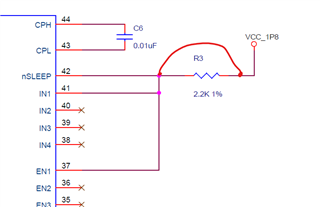

    We received PDRV8962DDWR Samples from TI and started to evaluate the IC with respect our requirement.
    Please find the below mentioned details which we carried rework during validation. (We planned to validate the IC by Step by Step; first step is to validate the IC instead of giving PWM we set 1.8 DC to DRV8962, IF it works next step is to provide the PWM but we didn't get the output voltage at PIN (4,5,6)]
    1) We set the pin as  nSleep=1.8, EN1=1.8 and IN1=1.8 V,but couldn't get the OUPUT Voltage
    2) we measured the voltage at pin 1 (VCP), Expected voltage should be 17V which includes the   input voltage and internal LDO,
    For example, I supplied VM is  12V, means I need to get 12+5 =17 at VCP pin, but we are receiving 12V at VCP.
    Kindly helps us on this.
    Here By I attached the schematic for your reference.SCHEMATIC FOR DRV8962.pdf

  • Hi Pooja,
    The capacitor C6 in your schematic is 0.01uF. It should be 0.1uF, please refer device data sheet table 7-1. Also connect a resistor to ground from IPROPI1 such that the Itrip comparator input will be at a known voltage level with respect to 3.1V VREF in your setup. For example if you connect a 3.3k to ground from IRPOPI1, the output current regulation will not kick in until 4.43A load current (based on the calculation with AIPROPI specification in the data sheet). You can download the EVM schematic from ti.com for your reference.

  • Hi Pooja,
    It is highly unlikely you may have damaged the driver IC with load never connected unless it was zapped with an ESD or connecting a supply voltage exceeding the specifications. Yes if you want to completely disable regulation and do not want any IPROPI feedback to the MCU you should connect it to ground. In the schematic you sent over the previous message it was floating. If you do need an analog equivalent voltage of the output current an RIPROPIx is needed on IPROPIx and sized such that although regulation is enabled it will never reach the Itrip value thereby never in the zone for regulation. And if IROPI1 was not set, the IC will not be damaged specifically with no load connected or no short circuit in the output. Even in this case internal OCP protection would kick in and protect the IC.
    VREF in the schematic is derived from DVDD output from the IC. The load on the pin by the resistors works out to < 1 mA. This should not impact the charge pump. How much was the drop in charge pump voltage? I assume correct value for C6 was used later on, the previous schematic had 0.01 uF.
    Yes, you must enable nSLEEP and EN1 for IN1 control to work. IN1 should be high for output HS FET to turn on. See table snippet from the data sheet.
    I noticed you have IN1, EN1 and nSLEEP tied to 1.8V via a 2.2K resistor. These three pins have internal pulldown typical value ~200k. The can vary and could be lower. The VIH min spec on these pins is 1.5V and hysteresis 150mV typical. I suspect you may not be exceeding VIH due to the 2.2k series resistor. I recommend bypassing this resistor and tying these pins to 1.8V directly to ensure VIH minimum input on these pins.

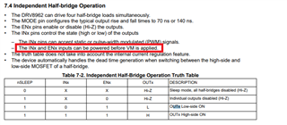

    Case 3: As per the data sheet, IN1 supposed to be powered before VM supplied. Initially EN1, IN1 and nsleep value had been set and supplied voltage at VM Pin (This is the procedure which has been mentioned in the data sheet and same has been followed), In between, with the help of software control, PWM had been disabled at IN1 pin and tested during working condition. Output should have been 0 volt whereas received 12V. i e input voltage)
    Case4: In continuation, IN1 set for 0 Volt and EN1 and nsleep set for 3.3V then supplied 12V to VM. with this condition, expected results observed.

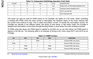

  • Hi Pooja,
    According to the statement in the data sheet you indicated with a red rectangle it says INx and ENx can be powered before VM is applied. It is not mandatory. In practical situations in an application VM may be active all the time. I just want to make this point clear. You can leave VM active.

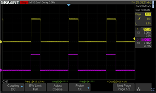

    See below the half-bridge operation truth table from the data sheet. As per this table when EN1 = 1 and IN1 PWM = low, OUT1 low side will be on and it will read 0V with respect to ground, When EN1 =1 and IN1 PWM = high, OUT1 high side will be on and it will read VM voltage with respect to ground. Note internal current sensing is in the high side of the half-bridge only. In order to realize current regulation load must be connected between OUTx and ground.
    See below scope capture EN = 1, IN1 = 25% PWM pink trace between IN1 and GND, OUT1 yellow trace between OUT1 and GND. I do not see any issues with the described behavior of the half-bridge.

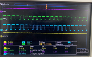

  • Dear Murugavel,
    Please look over the details below about the validation we did today.
    1) As you suggested, we connected resistive load to the OUT1(4,5 and 6), still receiving DC in output side . [[In this scenario, NSLEEP=3.3V, EN1=3.3V, and IN1=PWM were given.]
    2)  IN2,IN3,IN4,EN2,EN3,EN4,IPROP2,IPROP3,IPROP4,PGND2,PGND3,PGND4,MODE ,OCPM  these pins are in the floating state, any reason behind this to not get PWM OUTPUT??
    3)I've captured the image during different working condition.
    Please assist me in determining where I need to make changes.
    Image 1 Descriptions.
    Violet is IN1-3.6V,PWM
    GREEN: OUT1 -5V
    BLUE: EN1-3.6
    YELLOW: NSLEEP-3.6
    IMGAE 2 Descriptions:
    VIOLET is IN1-3.6V]
    GREEN EN1 -PWM INPUT 3.6V 10KHz
    BLUE OUT1 -PWM OUTPUT (5V ) 10KHz
    YELLOW: NSLEEP 3.6V DC
    Pooja Ak
  • Hi Pooja,
    I'm unable to reproduce the issue you are experiencing. Could you please double check the schematic and the circuit board you have? Do you happen to have one of our DRV8962EVM to compare? If not I recommend you order one of this EVM for evaluation and comparison. Can you perform and compare this same test with another DRV8962 sample using your PCB?
    Leaving IN2,IN3,IN4,EN2,EN3,EN4,IPROP2,IPROP3,IPROP4,MODE and OCPM  pins in floating state while you are working with only IN1 channel is fine. However for best practice I'd suggest you connect PGND2,PGND3,PGND4 to ground along with PGND1.
    In both images you sent VM DC as well as VM PWM is shown as 5V. However the reference schematic I received shows VM = VCC_12, I assume 12V. Did you use VM = 5V for testing? Can you also do waveforms capture with no load connected? Can you also connect a 10k pull-up resistor from nFAULT to DVDD and check the status of the nFAULT pin to see whether a fault condition exists during your tests? Thanks.
    Regards, Murugavel
  • Hey Murugavel,
    Thank you so much for your extending support,
    1) I have verified at fault pin, we observed low voltage and by replacing the new IC, got PWM output.
    TI   ----In both images you sent VM DC as well as VM PWM is shown as 5V. However the reference schematic I received shows VM = VCC_12, I assume 12V. Did you use VM = 5V for testing?
    Waveform image which was shared to you was having input voltage of 5V, yes, for testing purpose input voltage varied from 5 to 25.
    Still validation is in progress, I will update you .
    Pooja Ak
