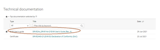

    Thank you for your question.
    There is user guide TI.com.
    www.ti.com/.../DRV8244S-Q1LEVM
    Starting from page12, it shows GUI set up procedure. Could you refer it?
    And it shows option for Cloud-based GUI on section 4.2. Please try it if install does not work.
