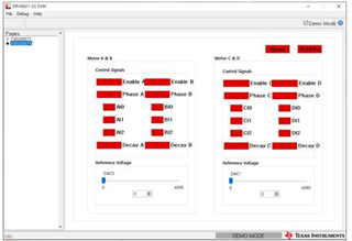

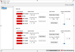

After installing Setup_DRV8821-23_EVM.exe, when running DRV8821-23 EVM.exe,
Please see the test screen first.
  1. DRV8821 Test Screen
  1. DRV8823 Test Screen

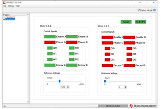

When I press the Phase A and B buttons after setting as above,
I checked the movement of Motor, but it is not continuous.
I want to make continuous movement like as below, I cannot find the way to solve this issue.
Phase A : H -> H -> L-> L ………..
Phase B : L -> H -> H -> L ………..
as you can see DRV8821 Test screen,
I want to ask you how to run continuous by setting up PPS and Accel-Rate time base

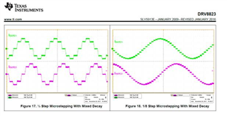

In addition,
hope to check how to work in two ways like the data sheet as below.
