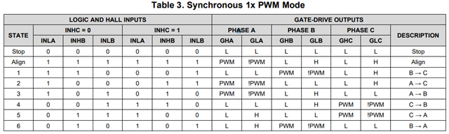

    The difference between the 1x and 6x PWM mode is that 1x PWM mode is setup to execute sensored trapezoidal control which would make it a closed-loop control as it uses sensors to provide feedback to regulate the inputs. The table below lists the different outputs you can expect based on the Hall sensor inputs that would need to be given for the 1x PWM mode:

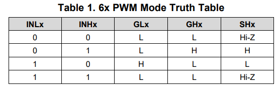

    With 6x PWM mode, you would reference the following truth table to program the commutation control method that is desired.
    6x PWM mode allows for more control, though it requires the commutation control method to be programmed manually by the user whereas the 1x PWM mode is already setup for trapezoidal control.
