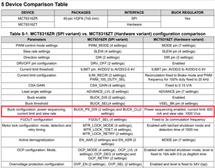

  • Hi Uri,
    For the Hardware version of MCT8316Z AVDD is always connected to the buck output to minimize system power losses. In the datasheet it is referred to this as Power Sequencing in section 8.3.4.4 AVDD Power Sequencing on Buck Regulator.
    In the table in the datasheet featured below, it shows that for the hardware version of this device, power sequencing is enabled:
    I hope this answers your question and if it does, please help my marking this thread as resolved!
