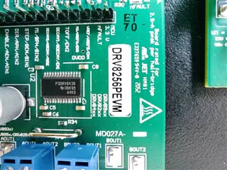

The motor driver chip of the evaluation board should be DRV8256, but the motor driver chip on the evaluation board we received is P3DRV8436, please help to confirm whether there is any error

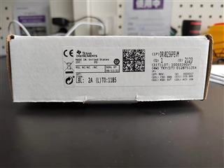

When did you place the order for this EVM? can you send a picture of the side of the EVM box near the label sticker?

There was an issue with some of the boards where the incorrect IC was soldered. This issue was solved almost a year ago. It seems the board you have was ordered before the boards in inventory were fixed. If you order an EVM now, you should obtain the correct EVM with IC populated.
Apologies for this inconvenience.
