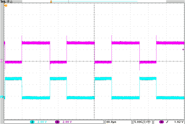

Meanwhile, I have further question about DRV8329 usage, I have done double test for PWM generation:
P0-Normal
Background: Connected power supply pin, set INHA & INLA on with PWM, then measure OUTA voltage.
Phenomenon:
Gate driver:
OUTA:
nFAULT: ~2.5V. For this situation, the voltage of nFAULT signal is not closed to AVDD, which is 3.3V. Is it normal?
Update: I check its voltage (with and without MCU pin, which is used to read nFAULT voltage), and it is related to MCU pin input resistor, so it should be normal.
P1-Abnormal
Background: Connected power supply pin, set INHA on with PWM and INLA off, then measure OUTA voltage.
Phenomenon:
Gate driver:
OUTA:
nFAULT: ~0V. Fault happens. What causes fault, no current circuit added?

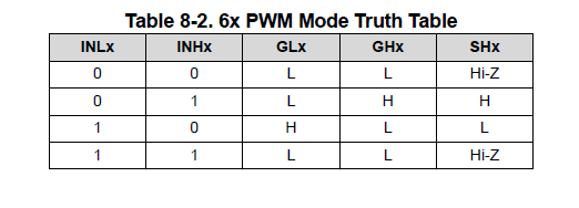

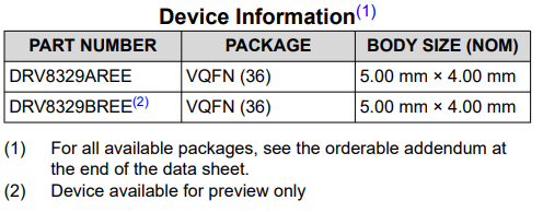

    Regarding your first question, the DRV8329 has 2 variants: the DRV8329A (which supports PWM Mode 6x) and the DRV8329B (which supports PWM Mode 3x).
    At the moment only the DRV8329A variant is available as specified by the following:
    So at the moment, only the 6x PWM mode is available.

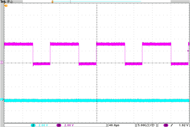

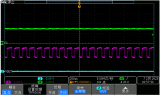

    To clarify, for the waveforms that you have shared, does the pink line for the gate driver waveforms represent INHx or INLx? Which one does the blue line represent? Also, what do the pink/blue lines represent in the OUTA waveform? Is it the GHx/GLx/SHx?
    Do you know what could be causing the fault to occur? If not, try monitoring the voltage for the following pins: PVDD, AVDD, GVDD, and the voltage across BSTx and SHx.
    ~Alicia
  • Hi Alicia,
    Thanks for your reply, I understand DRV8329B is not available now.
    Here is the instruction for the signal I graphed.
    Gate driver:
    Pink: INHx (INHA)    Blue: INLx (INLA)
    OUTA:
    Pink: OUTx (OUTA)    Blue: GND(not used)
    nFAULT: ~0V. Fault happens. It is not clearly what causes fault.
    Pink: nFAULT     Blue: GND(not used)

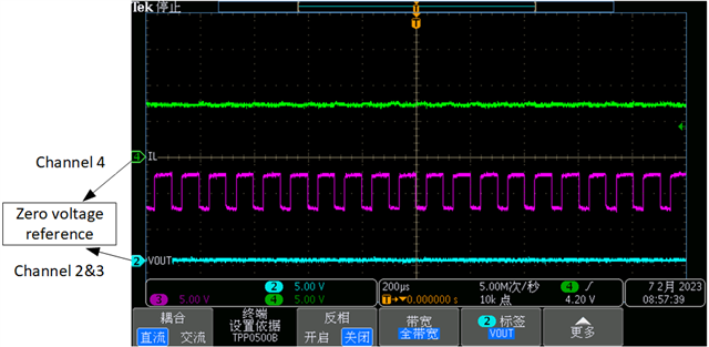

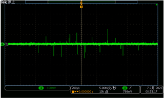

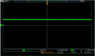

  • Hi Alicia,

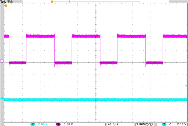

    Here is the update, I think it normal when operate in Hi-Z mode.
    When I set the DRV8329AEVM board input as below:
      (Green is OUTA; pink is GHA; blue is GLA; all connected to GND)
    So, considering there is no load for OUTA, so capacitor make the voltage maintain. Does this make sense?
    • Voltage across BSTx and SHx pins
    • VDS voltage drop across RDS(on)
      • High-side: Voltage across PVDD and SHx pins
      • Low-side: Voltage across SHx and LSS pins
      (Green is High-side: PVDD->SHx)
    • Voltage drop across external current sense resistor between LSS and GND pins
    Best Regards
    Sal

  • Hi Sal,
    However, I don't find any hardware pin number to settle it PWM mode. Can you give me some suggestions?
    If you don't know how to set what PWM mode, then why you referred to the 6x PWM Table for your questions?
    Brian
  • Hi Brian,
    In the first, when I use 6xPWM for test, there is no other error, so I assume 6xPWM is available.
    Then, Alicia has nicely give me the feedback as below:
    I am using DRV8329A, so it only 6x PWM is available, which I used in analysis.
    Best Regards
    Sal

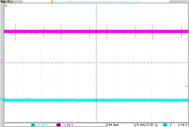

  • Hi Alicia,

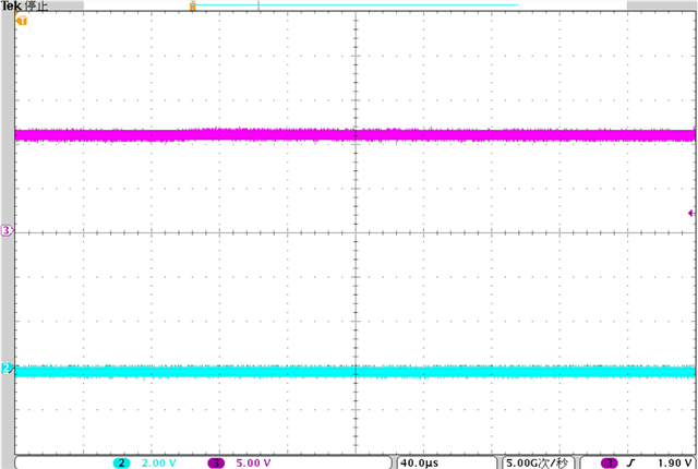

    Yes, it is exactly what happened. You can try below signal for verification:
     (Green is OUTA; pink is GHA; blue is GLA; Other INHx/INLx is no input)
    With the signal I posted, every time when I power up, DRV is set fault, and only when I give a quick low logic pulse to nSLEEP can I release the error.
    Then, if I try the signal below, few times DRV is set fault when I power up, and more often it runs normal.
     (pink is IHA; blue is ILA; Other INHx/INLx is no input))
    Note: The test result is get from DRV8329AEVM.
    Best Regards
    Sal
  • Hi Sal,
    OUTA:
    You were asked to clarify if the pink waveform was GHA or GLA, but your answer was OUTx (OUTA). This driver is a gate driver, and so there is no such thing called OUTA output. You are a Ti engineer and it seem carelessly respond to other people trying to help you, wasting their time.
    Brian
  • Hi Sal,
    Let's look at what you wrote and the captured waveform:
    1. it is not clear what voltage is OUTA waveform -- is it 0v or high voltage? We don't even know what is the voltage applied to the upper FET Drain (PVDD) -- 24v or 60v or anything?
    2. "(Green is OUTA; pink is GHA; blue is GLA; all connected to GND)"
    all connected to GND? or all signals are referenced to GND?
    3. Pink waveform (GHA) is switching about 5v rail to rail, and again, without knowing the lower rail voltage, I would assume it's switching from 0v to 5v, which is totally wrong for GHA output.
    4. Blue or GLA: is it 0v or 5v logic? I can't tell from the scope pic.
    "Does this make sense?"
    It makes zero sense to me reading this.
    Brian
  • Hi Brian,
    Let me clarify it.
    1. I am using DRV8329AEVM, so you can find the OUTA in PCB board. Meanwhile, it will be connected to SHA.
    2. It is high voltage, because you can find it in waveform that it is ~7V (Green one, OUTA). Therefore, it can be inferred that the bus voltage is 7V, which is PVDD.
    3.Sorry for the description not precise. I mean that all signal is reference to GND.
    4.The pink waveform reference low voltage is not display, and it is the same as blue signal, I think it can be recognized so I have not comment on it. In the waveform, GHA is switching from 7V to (7+5)V. Then, I think it should be correct.
    5.I think it is clearly in the scope waveform that blue one (GLA) is 0V, can you clarify why it is misleading?
    6. In the waveform, we can know that the OUTA (SHA)  is switching from H to Hi-Z, if it has load in output, the output voltage should be like square wave. However, there is no load in OUTA, and then the output voltage  keeps high.
    Best regards
    Sal

  • It is high voltage, because you can find it in waveform that it is ~7V (Green one, OUTA).
    Looking at the pic, how does one tell Green is 7v and Blue is 0v, without knowing where is 0v reference is? No mindreader here.
    If GHA is witching from 7v to 12V -- only 5v for VGS, then it is not correct as I don't think this driver drives the gates with only 5v.
    Brian
  • Hi Brain,
    1. 0V voltage.
    0V voltage reference is always shown in the left.
    2.VGS voltage
    I think it is relevant to that there is no load in OUTA (SHA), so the load current is zero, which cause the situation.
    If the clarification is not reasonable, I can figure it out later.
    Best Regards
    Sal
