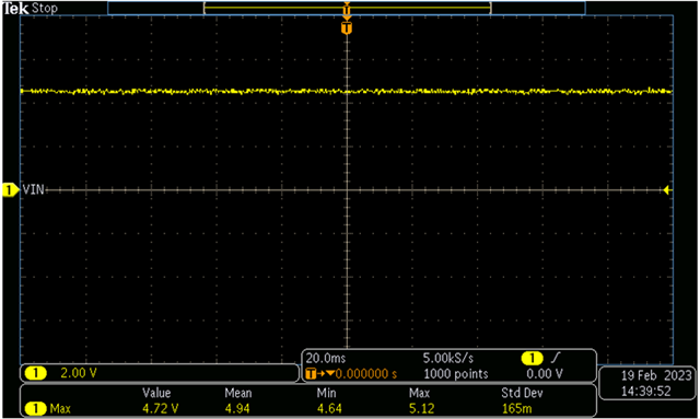

When I test on DRV8329AEVM, it shows a strange phenomenon that when INHx&INLx is input ahead of DRV powered up, DRV always make itself fault after powered up.
The specific action is below:
  1. DRV is not powered
  2. INHA and INLA are given some input (one is given high signal, etc.), others are no input.
  3. DRV gets powered on
  4. Fault occurs
The following waveform can describe the signal I used. Every time when I power up, DRV is set fault, and only when I give a quick low logic pulse to nSLEEP can I release the error.
Note1: This is the normal waveform after reset. And, Green is OUTA (SHA); pink is GHA; blue is GLA; Other INHx/INLx is no input.
Note2: OUTA is around 7V; Pink is around 7V~12V; Blue is 0V; all signal are reference to GND in EVM.

    I have done a test that send signal after power up, yes it will run normal.
    Then, I found a interesting thing that when PVDD is higher than 7.5V, DRV will run into fault, and it can not be released (HiZ mode test).
    To find what happened, I check the voltage between BSTx and SHx. It shows below (PVDD = 7.5V; no fault here):
    Therefore, it is relevant to BSTx undervoltage fault.
    When it runs in HiZ mode, such as INHA = PWM; INLA = Low. Due to there is no load, VSHA keep the same with PVDD (In PWM mode, VSHA will be switching from PVDD to 0V). Which makes BSTA is smaller than PWM mode, then fault happen. I hope this will be helpful for DRV application.
