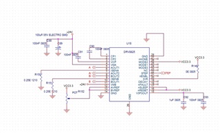

i am evaluating DRV8825 for my application with motor spec (24V ±10% current: 1 phase 0.6A, 2 phase: 1.2A), planning to use in 1/16 OR1/32 mode
i have adjusted Vref. to 0.685V, now i am able to drive the motor correctly,
let me know whether this Verf voltage is sufficient ?,
What will be set current for each coil in this case?
Do i need to increase OR decrease current?

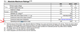

For two layer, 1oz copper board, does the recommended PCB layout (heat sink) is sufficient OR i need external heatsink (my operating range is 10 degC to 55degC) ?
