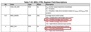

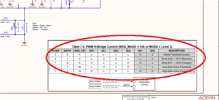

    Based on your register value, you set BRG_MODE = 01 and BRG_FW=0
    Therefore GHx/GLx will output as follows.  Without your IN1/IN2 input condition, it is difficult to judge your result is correct or not.
    I suggest to scope a) IN1/IN2/GH1/GL1, N1/IN2/GH2/GL2 and N1/IN2/SH1/SH2. Then we can compare with above table to confirm.
    By the way, you are attaching table for PWM, although you are choosing PH/EN mode. FYI.
