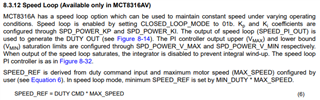

  • Hello Taito Takemura,
    MCT8316Z does not have built-in speed loop so it does not support constant speed. For this device when load increased, speed will eventually decrease.
    However, MCT8316A and MCF8316A both support constant speed under varying conditions, see the screenshot from the MCT8316A datasheet below:
    MCT8316A and MCF8316A are both sensorless solutions which should benefit the customer's application. Let us know if you have any additional questions about the speed and torque loop feature in MCX8316A which supports constant speed and dynamic load!
