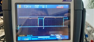

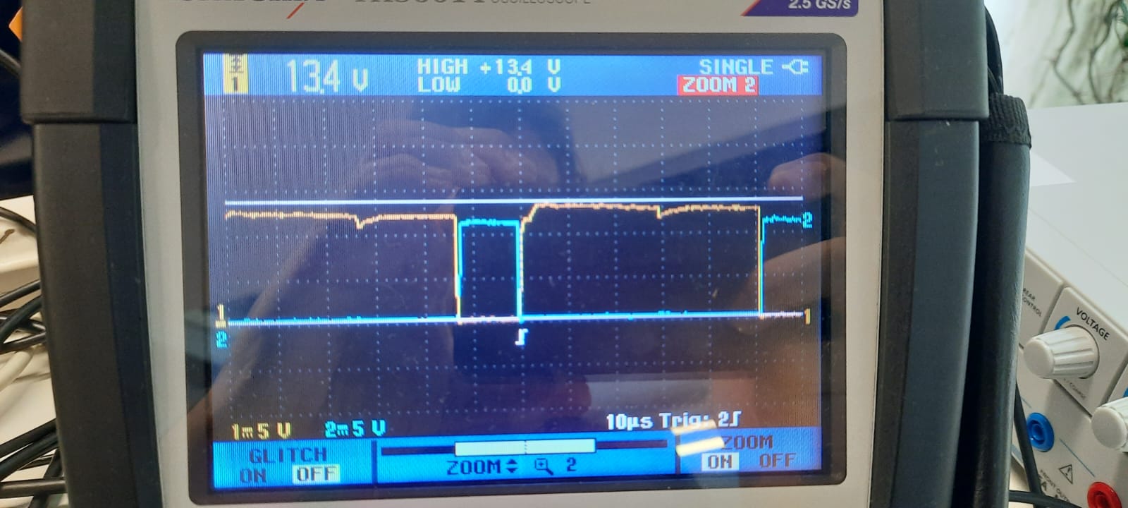

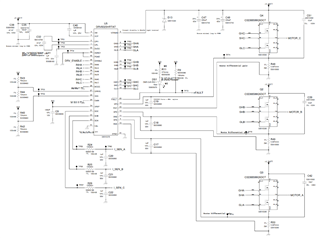

I'm developing my own custom board using this chip, and I've been having some burning issues, shorted half-bridges and drivers. Ringing and thermals were the primary suspects, but yesterday I found this while measuring the GHx.
Yellow is GH->SH and blue is GL->SL
As you can see the GH goes to 13.5V, which is out of spec for this driver:
 (Vmax = 13.5V)
And this is measuring GH, GL and VM->VCP (purple)

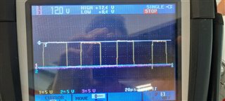

This is a GH measurement, but this time in the evaluation board, which stays on spec. (Vmax = 12V)
