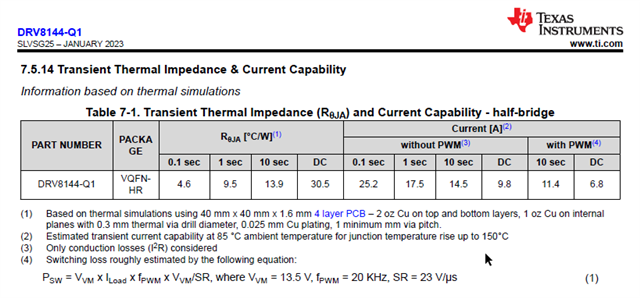

Hello TI team ,
I did't find min. slew rate in datasheet , could you provide the min./max. slew rate value ? because I need these values for worse case calculation, as I know the slow  slew rate will get bad thermal . (I use "LVL5" in my application )
Can you provide RthJC parameter like bellow screenshot?
Thank you!
