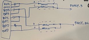

Hello, we are currently troubleshooting our DRV8412 design because we are experiencing latching shutdowns while driving a stepper motor at currents of greater than 3A.
I believe we have eliminated undervoltage protection as the reason for shutdown by probing GVDD during FAULT conditions. There is no significant droop on our 12V GVDD supply (approaching 8.5V UVP threshold) at the time that FAULT is asserted, and we have further reduced this risk by including additional local decoupling at the DRV8412 GVDD pins. Also, we have found that the OTW pin remains HIGH during FAULT conditions.
Therefore, I believe we are experiencing an overcurrent shutdown (Level 2).
Below is our design using individual DRV8412 parts to drive each phase of a stepper motor. We are using paralleled outputs to increase the current drive capability of the design.
Please note that since we have started troubleshooting, we have modified the above schematic design with the following:
  • C419-C422, C441-C444 with 2.2uF capacitors
  • R351 & R391 with 27kΩ resistors (OC threshold = 9.7A)
Even though the currents passing through the windings (~3A RMS) are not close to the OC threshold (9.7A), we thought it possible that some current was shooting through the low-resistance paths directly between OUT_A & OUT_C, and OUT_B & OUT_D on each DRV8412.
To test a fix for this, we altered the output inductor configuration to match Figure 15 from the DRV8412 datasheet, in line with the recommendation in Section 9.4.5. This is summarized in the diagram below.
Doing so led to slightly less frequent FAULT conditions from OC latching shutdown when running at over 3A RMS, but these failures would still occur. We also tried placing the DRV8412 into Mode 3 for Parallel Full-Bridge outputs (which required reworks on both input PWM and output drive configurations), but did not see a noticeable difference between the functionality of the design or frequency of FAULT conditions.
Also, it may be important to note that the output filter we are using is the common mode filter SBP-5001T.
Can you please review our design and implemented reworks to suggest possible tests and fixes for our operation?

    It sounds like you have done a significant amount of debug work and if you are seeing latching in CBC mode, then it should be level 2.
    Have you tried removing the CM filer on the outputs as a quick test?  I have seen issues with these type of filter networks before.

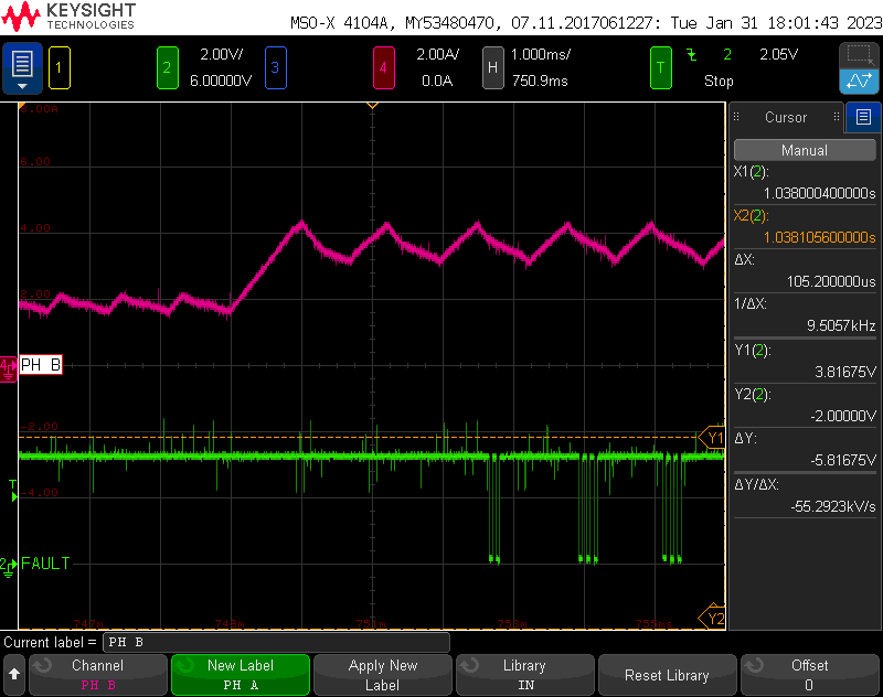

    In addition to the above question regarding stepper motor failure modes, I have another question about the FAULT behavior while operating at about 3.7A.
    I have switched back to the higher current-rated stepper motor and with my current configuration, it successfully protects against shutdown at HOLD (DC) currents of 3.2A. To test the limits of its overcurrent protection, I increased the current to about 3.7A DC and saw the following behavior. Note that the magenta trace is Phase B winding current and the green trace is the FAULT signal.
    After reaching the 3.7A DC level seen above, both waveforms continue for 700ms until the FAULT fully asserts and PH B current drops to zero. To me, this appears to be CBC current protection. Would you agree?
    If it is indeed CBC protection, do you know why it is occurring at a current of 3.7A DC when the OC_ADJ resistor is set to 27kΩ, resulting in a 9.7A OC protection threshold?
    It may also be important to note that the pictured Phase B current corresponds to a DRV8412 (U64 in schematic) currently in Mode 1, whereas the other Phase A DRV8412 (U66) is in Mode 3. U66 continues to output phase drive signals after the FAULT on U64 asserts. Based on my understanding of the datasheet, however, the DRV8412 mode should not affect the OC_ADJ threshold, as the CBC current limit should be independent of each half-bridge.

    Can you also plot at least one input and corresponding output on the scope capture?  If input does not match output, you are in CBC as CBC will truncate the input pulse until the next rising edge on that input.
    Also, there is a note in the datasheet for mode 3.  One of the advantages of mode 3 is synchronized internal switching even during CBC.  Without using Mode 3 in your configuration, you really can get some unpredictable behavior.

    I had already reworked the Phase A driver (U66) to set it to Mode 3 prior to your reply. With this configuration of both drivers in Mode 3, I am not seeing any FAULT pulses that may indicate CBC current limiting.
    Instead, I am seeing that 1 of the 2 drivers will FAULT instantly upon reaching the 3.7A DC level without any evidence of CBC limiting (looks like Level 2 OC shutdown). However, the driver which FAULTs is directly dependent on the desired direction of the rotation drive command. If I send a "Move POS" command, the Phase A driver (U66) will fail instantly upon reaching its max current. If I send a "Move NEG" command, the Phase B driver (U64) will fail instantly upon reaching its max current.

    We are currently using a different configuration in which we have disconnected the OUT_C and OUT_D traces on each motor such that the OUT_A and OUT_B signals are sourcing the full current. In this configuration, we are able to drive the motor at a consistent 3.7A DC without shutdown (likely due to lack of connection between DRV outputs).

    If you are not seeing any faults with OUT_A and OUT_B sourcing all of the current, then we can rule our temperature dependencies.  Sounds like it is a "false" OCP that is occurring with the parallel connection.  Using Mode 3 should address this.
    Ryan
