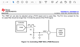

Quick question here that how can I judge the value of Rref1 and Rref2 for Vref?
the recommend of two is less than 50-kohms.

Use values of 10k or greater and you will be find. It is just a resistor divider circuit so you can adjust VREF based on your desired full scale chopping current needs. Calculations are in the datasheet for current as it is related to VREF.

Where can i find the Calculations ? I just find low pass filter R-C time of VREF.

The full scale current calculation is in page 20 of the datasheet.
