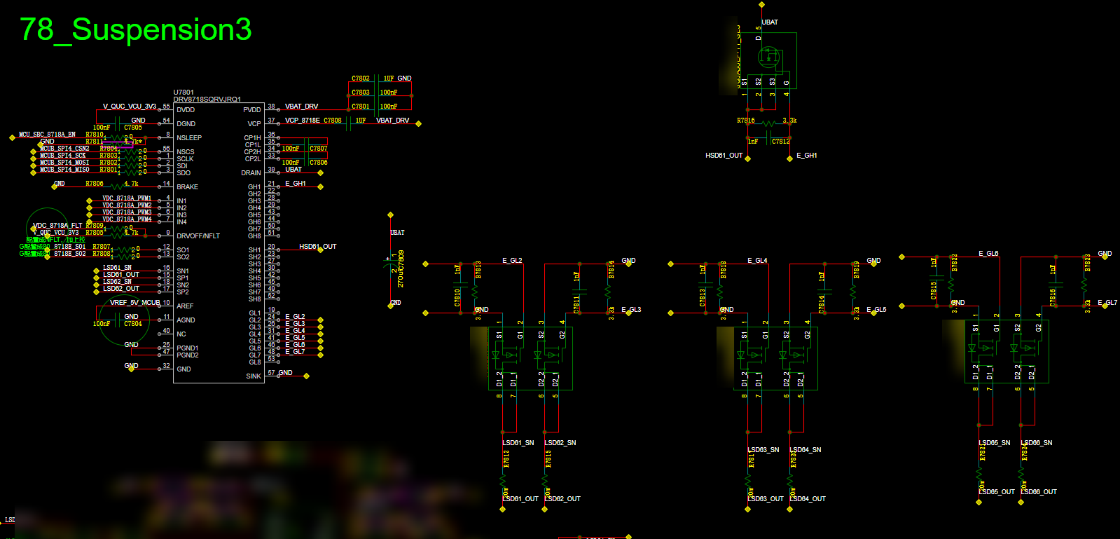

Dear expert,
Customer  use DRV8718 for low side driver as below picture.
I think they don't need to connect SHx to MOSFET Drain pin , right?
SHx pin is only used to sense voltage of high side MOSFET sourcing pin, right?

  • Hi Team,
    The purpose of still adding one high side FET, is because they worried about if anything happened on the low side FET, make it unable to be turned off, they still can turn off the high side FET.
    Means high side FET turned on, and low side FET output the PWM.
    The schematic is under here, will it work?
  • Hi Peter,
    Thank you for your question.
    From schematic, it is difficult to judge how loads are connected externally. however, if it is like below, should be OK.
    regards
    Shinya Morita
  • I agree with Shinya that each inductive load should have a Schottky diode in parallel.
    Brian
