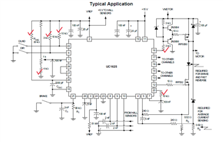

Hello ,
I am using the UC1625 and build the circuit on breadboard same as application note.
I have Maxon motor connected to the circuit. Low side don't activate and when I rotate the shaft manually. I can monitor the high side toggling to the different phases but Low side steady state at almost zero.
Even I removed the connection to the pins 12/13/14 and don't see any activity on that pins to change from (H to L) or (L to H) while I turn the shaft with hand.
What could prevent the toggling on low side!?
