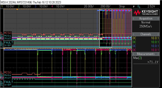

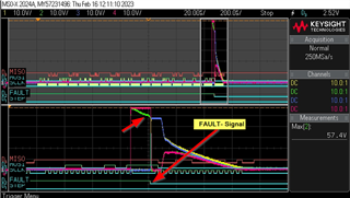

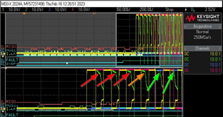

  • We have observed this error on several PCBAs, it only occurred after some time and interestingly it only affects the A2HS signal so far. The supply voltage is 48V and the MOSFETs used are Infineon BSC070N10NS3G (see excerpt from data sheet below).
    We have carried out further measurements. Insight:
    - Figure 1: If the B1HS signal is active first after an ENABLE, then there is no error.
    - Figure 2: If A1HS is active first after an ENABLE, we see that A2HS weakens during the first pulses, but then recovers. No error:
    - Figure 3: If A2HS is active after an ENABLE, then there is an error.
