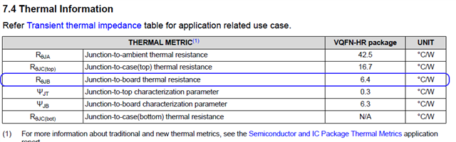

Hello Team, following question from customer:
is regarding the blue marked RΘJB the thermal resistance related to GND Pin meant?

Hi Josef,
Thermal resistance is not related to GND. Please refer this application note.

Hello Shinya, feedback from customer:
"could you please indicate the thermal resistance between junction and the GND pin.
We are asking because in our case the GND pin is connected the GND plain of a 4-layer board."

Hi Josef,
Thank you. Based on your description, Junction to board thermal resistance could be one. Please share 6.3C/W as datasheet.

If GND pin is tightly connected to PCB of GND as describes, GND pin temp could be almost same as PCB of GND. So I have mentioned that way previously.
