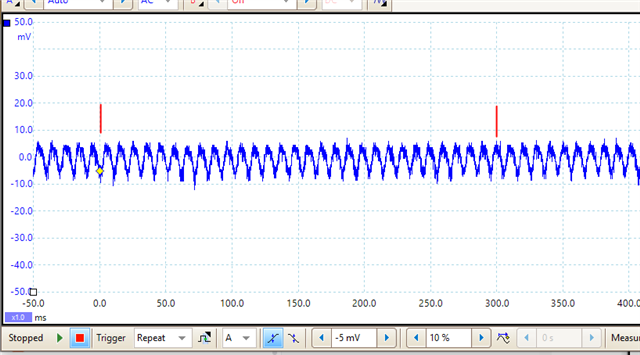

We are using the DRV8912 in some of our designs for driving motors and other inductive loads.  We are seeing that some noise on the logic VDD rail (3.3V in our case) when driving certain loads, and turning them on and off.
For example, image1 is an AC coupled trace of the 3.3V net when we are driving a motor with PWM but full duty cycle.

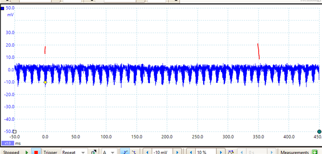

image2 is the same motor but driven at ~50% duty cycle.

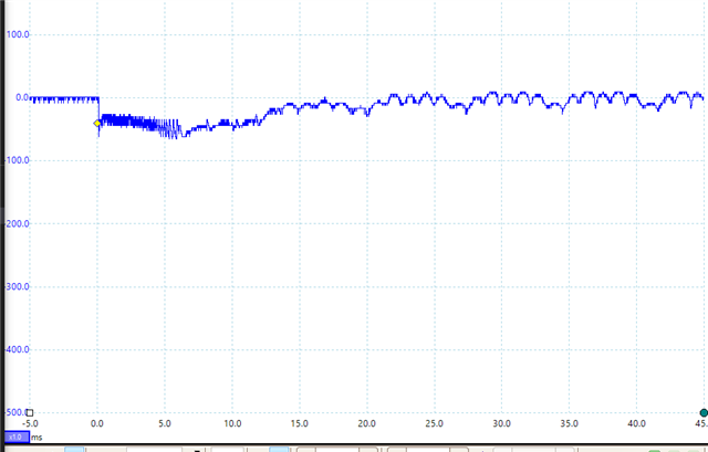

image3 shows a transient on the 3.3V net when the motor is initially turned on (on the left of the plot where the supply is stable, nothing is being driven by the DRV.

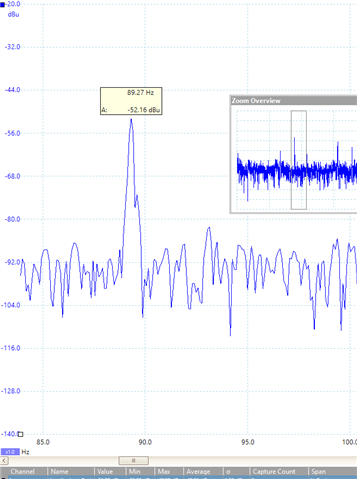

PWM frequency is 2kHz in each case.  We see noise on the 3.3V net at around that frequency, but also at a lower frequency as shown in image4 which is presumably something related to the motor speed (since its centre position increases as the PWM duty cycle is increased):
My question is, is there any particular isolation or filtering that we shold pay attention to, or you can suggest, to prevent this noise coupling back into the VDD supply?

  • Hi Oliver,
    Thank you for your questions.
    A couple of possibilities.
    1. First I suggest to check VM and make it stable. If your VM ripple is large (~>500mV), you could try to increase Bulk cap on VM line.(e.g adding ~470uF). It could help.
    2. Recommend to have 1uF cap close to VDD pin.
    3 PCB layout. Here is example on datasheet. If VM or some of OUTx cross over VDD line, it may cause coupling.
    VM supply does not damage VDD supply as long as lower than Vin max.
    regards
    Shinya Morita
