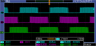

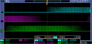

    Capture scope waveform of VGHx and VGLx to see what pwm duty so we can understand why motor didn't get to setting speed.

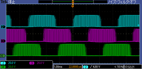

    ->Our customer captured the waveform of U, V and W.
    (Normal case : In case of changing the voltage from 16V to 24V, after changing voltage(24V) power on reset or Enable pin toggle)
    (NG case : In case of changing the voltage from 16V to 24V with keeping on the voltage)
    VM voltage is the same 24V, and register setting is the same.
    However, there is the different output voltage(ON duty)
    Therefore, in case of start-up, does the device confirm the VM voltage? And does the device configure any internal settings?
    Kind regards,
    Hirotaka Matsumoto
  • Hi Hirotaka,
    I asked for VGHx (high side gate drive signals) waveforms but the customer provided the motor phases waveform U,V,W.
    Anyway looking at the waveforms, it's clearly that for the normal case, it is a 120* 6-step Hall sensor commutation, while the NG case is a sinusoidal current commutation (with space vector pwm). You need to find out why the commutation mode is not the same for the two cases. However, nothing is wrong with using sine current mode, as it drives the motor smoother and less switching loss for the power FETs.
    What is SMODE pin logic voltage? BASIC and ENSINE bits value?
    Brian

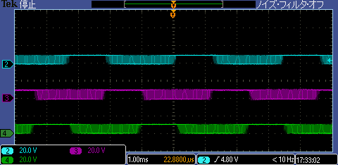

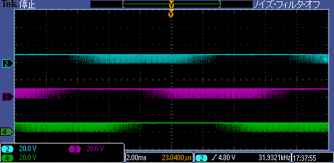

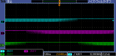

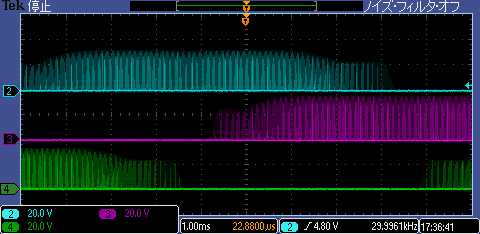

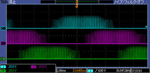

    ->We encourage the customer capture these wave forms;
    <Normal case CH2=UHSG, CH3=VHSG, CH4=WHSG>
    <Normal case CH2=ULSG, CH3=VLSG, CH4=WLSG>
    <NG case CH2=UHSG, CH3=VHSG, CH4=WHSG with time range 2ms and 1ms>
    <NG case CH2=ULSG, CH3=VLSG, CH4=WLSG with time range 2ms and 1ms>
    Kind regards,
    Hirotaka Matsumoto
  • Brain san and Vishnu san
    As the result, the register setting is the same.
    However, there are difference waveform between Normal case and NG case.
    -Normal case : In case of changing the voltage from 16V to 24V, after changing voltage(24V) power on reset or Enable pin toggle
    -NG case : In case of changing the voltage from 16V to 24V with keeping on the voltage
    Could you let us know the advice?
    Kind regards,
    Hirotaka Matsumoto
  • Hi Hirotaka,
    ->Address 0x03Bit15=BASIC=0,  Address 0x04Bit8=ENSINE=1
    The register setting should select the commutation as sine current, which is in the NG case with sine waves (actually the saddle waveform) at the 3 phase wires.
    Then why the normal case (applied 24v directly) the commutation shows it is a 6step commutation?
    It seems like the SPI registers were written too soon and so they don't have the correct data, instead of wait a little delay later?

  • Maybe the NG case is not in sine current as I first thought, but because the NG case waveform was zoomed in too much so they look like sine waves.
    Hirotaka, why did you capture the normal case with 3 cycles commutation for each signal, but for the NG case, you only captured one cycle for each signal? Please capture the scope again for NG case with 3 cycles for 3 u,v,w signals.
    Brian
  • Brian san
    Thank you for your prompt reply.
    ->We understand your mention, however the customer confirmed register with readback in both case.
       Write -> Read -> Confirmation of the same register setting
       Just in case, we will encourage the customer to confirm again.
       Then, we would like to confirm, is there the case which register data is the same however don't have the correct data?
    ->Because, in case of NG case, the rotation is slower than Normal case.
       In order to compare two waves with the same time range, the customer captured 1cycle.
    Kind regards,
    Hirotaka Matsumoto
  • ->Because, in case of NG case, the rotation is slower than Normal case.
    We understand the NG case is slower, but please ask the customer to capture the NG waveforms with the same information (number of cycles) using longer time base which is fine. Waveforms are more important than the time base on the scope.
    What do the customer want: 6-step or sine-current commutation?
    Brian
  • Brian san
    Thank you for your reply.
    We encourage the customer to capture waveforms aganin.
    ->sine-current commutation.
       Because the configure sine current commutation,
       -Address 0x03:Bit15=BASIC=0,  Address 0x04:Bit8=ENSINE=1
    Kind regards,
    Hirotaka Matsumoto
  • Anyway looking at the waveforms, it's clearly that for the normal case, it is a 120* 6-step Hall sensor commutation, while the NG case is a sinusoidal current commutation (with space vector pwm). You need to find out why the commutation mode is not the same for the two cases. However, nothing is wrong with using sine current mode, as it drives the motor smoother and less switching loss for the power FETs.
    I was wrong to say the the normal case is 6-step; it is sine-current commutation after looking at it again.
    So both the normal and NG cases are using sine-current commutation, but the NG case is running slower for some reasons.
    Brian
