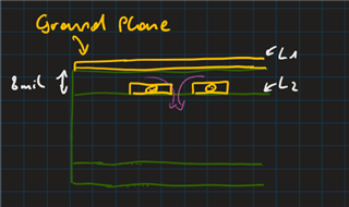

I have a question about of the layout from Gate-Traces. I’ve found a rough estimation formula to calculate the inductance of broad- and edge-coupled traces:
It’s clearly to see that the inductance of the broad coupled (option 2) traces are much smaller. But I’ve never seen a PCB layout that uses broad coupled traces, why is this so?
The only reason I can think of would be that the gate traces are so short that it doesn’t make a huge difference. But with longer traces (a few centimeters) that would make a difference.
The other reason I can think of would be that it's very impractical to route the gate trace in broad coupled form because for example in this layout below, I need the top and bottom layer as power planes (PVDD, GND) (and other things). I think I can’t put a power layer in an inner layer because of the heat distribution.
Are these the reasons or are there other things to consider?
What would happen to the inductance of the gate traces, when they are for example on layer2 and on the top layer is a ground plane? (like in the picture below) If it is changing the inductance, is there then a difference for the low-side and high-side fet gate traces?

  • Hi Daniel,
    The following Application Note details the PCB layout considerations needed for motor drive systems:
    Section 4 discusses general routing techniques regarding gate traces such as the need to make them as wide and short in length as possible. This helps to minimize inductance, loop area, and the possibility of noise caused by dv/dt switching.
    I would recommend looking over the App Note to learn about other/additional practices to observe in order to optimize your layout.

  • Hi Daniel,
    Personally I prefer to have the power planes VM and GND to be the inner layer next to each other for better coupling capacitance created by the 2 copper layers. For heat dissipation for the power FETs, I would have larger area of copper around the FET Drain pads and connected to the VM layer with many vias.

  • Hello Alicia,
    thank you for your answer. I’ve already read this document several times. I know the standard routing for gate traces but I wanted to ask, why I’ve never seen broad coupled gate traces, where the inductance would be much smaller for longer traces. And if a reference plane would affect the inductance of the edge coupled traces and if yes how.
    I tried to find books/references about it in the standard pcb design books, but I didn’t find any about this specific case.
    Daniel
  • Hello Brian,
    thanks for your tip. I also heard about that with the coupling capacitance, but I thought in my case where I have sometimes 60A on 2oz copper it could get very hot. And when using a calculator for the width, I got for the inner layer three times the width compared to outer layers. Therefore, I used the outer layers. The fets that I use in this layout are TO-220 with an heatsink.
    When you say inner layer for VM and GND is there than the pcb core between? Or do you mean that one power plane is on an inner layer and the other power plane is on an outer layer?

  • Hi Daniel,
    I didn't know yours running at 60A motor current -- serious stuff. At this high current, sure the heat dissipation is higher priority than layer-to-layer coupling capacitive. In this case, it makes sense to have the power and ground planes on the outside layer for cooling.
    To maximize coupling capacitance, I specified minimum thickness for the core.
    Brian
