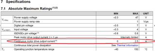

Hi Team,
May I confirm with you for the below maximum current, is it referring to average or RMS current?
Thanks.
Ernest
Hi Team,
Thanks.
Ernest
Hey Ernest,
We are referring to the RMS current in this instance.
Akshay
