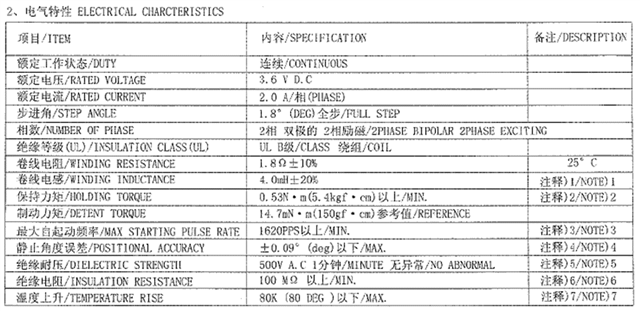

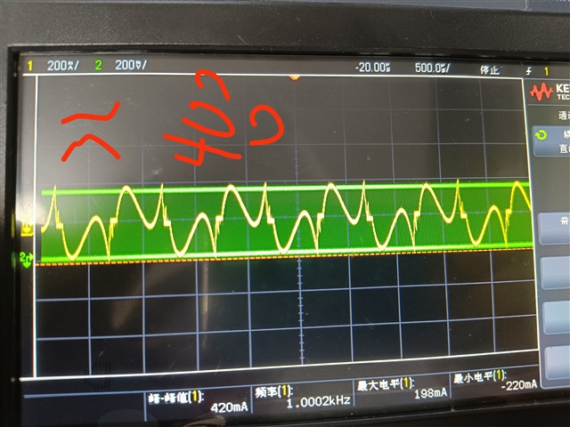

Customer are using our DRV8825 to drive a stepper motor which spec show as following. and the VM=24V, I_Chop=2A, 1/32microstep. When it works at 4000 step(1.8°)/s, the phase current show as following, and there is distinct noise.  Can you help to show your comments why does this phase current distortion happen?
