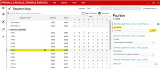

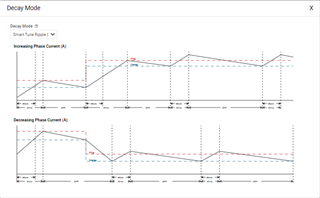

I test a stepper motor "midsize" with the DRV8462EVM. The Decay Mode "Smart tune Ripple Control" seems to give the best results for my setup. I would like to change the current rupple (RC_RIPPLE):
But can't find the field for it in the EVM GUI:
Hello Andreas,
This field can be set from the Register Page of the GUI. See below snippet.
