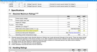

I.chop is referring to peak value.

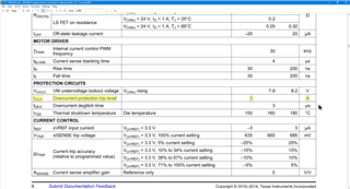

But, are rated output current and I.OCP refer to RMS / peak-to-peak / peak value?

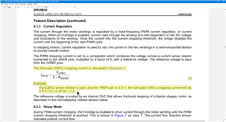

  • My design Vxref = 1.57 V.
    With R.Isense = 100 mΩ, I should have get I.chop = 3.14 A(peak) = 2.22 A(RMS).
    I.chop = 3.14 A(peak) violates OCP and rated output current ?

    I chop is referring to the maximum current the output current is limited to. Once the current hits the current chopping threshold, the bridge disables the current until the beginning of the next PWM cycle.
    The continuous motor drive output current is referring to the RMS current and we do not recommend exceeding the 2.5 A abs max spec of this driver.
    The OCP is the value of current above which the device disables the outputs. An analog current limit circuit on each FET limits the current through the FET by removing the gate drive. If this analog current limit persists for longer than the OCP time, all FETs in the H-bridge will be disabled and the nFAULT pin will be driven low. The device remains disabled until either nRESET pin is applied, or VM is removed and reapplied. Note that overcurrent protection does not use the current sense circuitry used for PWM current control, and is independent of the ISENSE resistor value or xVREF voltage.
    The 3A OCP is the minimum threshold at which an OCP event may be triggered, but it might vary based on temperature, load current, voltage etc. So the OCP in your system might be higher than 3A.

  • Hi Akshay,
    Appreciate your clarification, and they align with my understanding of the driver.
    The part I need is : "The continuous motor drive output current is referring to the RMS current and we do not recommend exceeding the 2.5 A abs max spec of this driver." And, I understand my I.chop = 2.22A (RMS) still within rating current.
    My following-up question is : is OCP (min) 3A also referring to RMS current (no peak current, similiar to I.chop) ?
    Jerry OOI.
  • Hey Jerry,
    OCP refers more so to the peak current, it is the maximum current that the device can sustain before getting shutdown to protect the driver.
