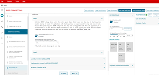

I have problems connecting to GUI 1.1.8. With the principle of the circuit, I designed as 2 pictures above.
I have the following connection:
R12=logic high BRAKE=ON
R13=logic high DIR=ABC
R11=logic high DRVOFF=ON
3V3COM=3.3V, VR1 rotate for output to 0V.
When I connect to GUI 1.1.8 it shows the following image.
Hardware connected, 32 registers read. But my motor is not spinning yet.
TI can help me check if I am wrong in hardware or software.
How to know if MCU has I2C communication with MCF8316?
How to set up the Motor's parameter in order to display " Motor status"? Are there any other parameters we need to set? Thanks!
When I don't connect USB wire from the PC to the board, the LED4 bypass pin "FAULT" is displayed. Could you explain more clearly them?
N.T. Vuong

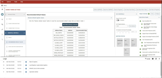

    Thanks for your response to your question. We have the solution to the problem. We used the firmware project for the MSP430FR2355 on the MCF8316AEVM from Eric Chen: e2e.ti.com/.../MCF8316AEVM_5F00_MSP430FR2355_5F00_Firmware.zip
    So we connect successfully, and the VM_Voltage 15V is displayed on the "Motor Status". We follow step by step the MCF8316AEVM Tunning Guide However, when we set up the I2C Speed Control, we have another problem with our BLDC Motor, the motor parameters (MPET) is not active after we active I2C speed control, and the Fault Status is not active during we set up. So our motor didn't spin.

  • Hi N.T. Vuong,
    I see that you were able to communicate with the GUI so it is my belief that the MSP430 firmware is working correctly. The I2C code should also be fine, otherwise the GUI would give an error immediately when the auto read buttons are enables.
    It seem like you may be running into errors when running MPET. I suggest that you turn off the auto-read motor status and fault buttons and then try to run MPET. If the fault LED comes on, then toggle on and off the auto-read buttons to read the fault.
    For your second question, does your motor have a directional load? If so, you would need to ensure that the phase wires are connected in the right order that spins your motor in the desired direction. This shouldn't impact MPET. However, it can affect the speed loop Kp/Ki values that MPET measures.
    Robert
