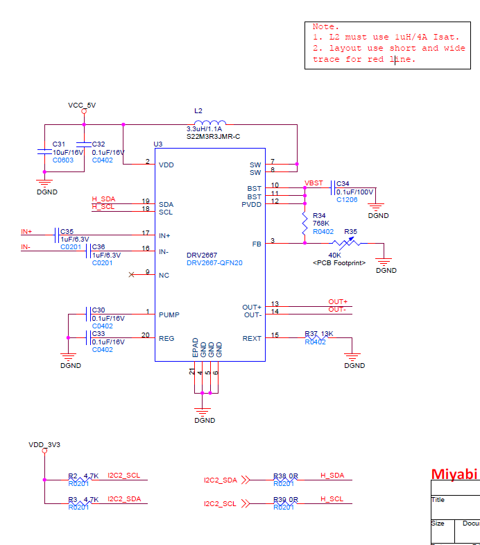

hi sir
could you help to double check the circuit ? or and advise in layout?
thanks

Hi Chen,
My only comment is that the datasheet recommends I2C pullup resistors of 2.2kOhm. Your schematic has 4.7kOhm. Chapter 10 in the datasheet also gives layout recommendations.
