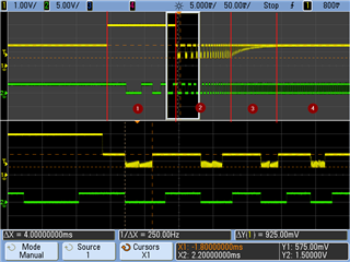

1. Is it possible to use the channel "DACOUT / SOX" or any other output to display the switching times of the half-bridges?
2. In the picture below you can see the FGOUT signal (green) and one of the SOX current sensing outputs (yellow). I would also be interested to know how the SOX signal in the four different sections is to be interpreted in relation to the start-up behavior of the BLDC motor.
