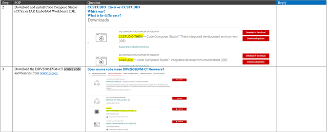

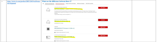

We have some questions about SW test environment. Can you let me know the specific software that we need to download to use the EVM?

Hi Roy,
The Haptic Control Console is the primary tool you will need. The API is used as an interface for the GUI to interact with other software.
For changes to the MSP430 on the EVM, you just need CCS Studio. The Theia version is just to integrate with the Theia IDE. The available firmware is so that you have a backup from any changes and so that you can make changes starting with the original firmware.
