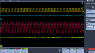

After learning and testing, our motor runs smoothly from open loop to closed loop when low-speed reference (less than 85% of maximum speed reference).
Here is our results about ground-to-phase current (red), ground-to-phase voltage (green), and FG (yellow)

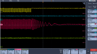

Our recent problem is that when the speed reference is set to more than 85% of maximum speed (high-speed reference), our motor still runs well in closed loop quickly, but it automatically stops without any fault alarm, and then its state returns to IDLE. Sometimes, when we set to more than 85% of the maximum speed, the power suddenly shut down because of an overcurrent error.

  • Here is the result when motor suddenly stops below:

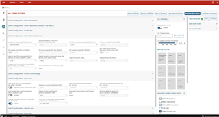

    Thanks for posting your question in MD forum. In the GUI, is the Auto-read enabled to read any registers? if so, can you please disable auto-read and try again? This is a known issue in the device and has been fixed in MCF8315A.
    Vishnu
  • Hi Vishnu,
    Thanks for your responses about our problems. We set up GUI and tested the motor and I am sure that the Auto-read was disabled but it not ok. At 85% of maximum speed, the auto-read was disabled and motor spined very well, but it suddenly shut down when the speed reference is set to more 85%.
    So we still have this problem. I hope you show us another explanation.

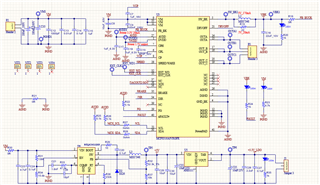

    What is your VM=? What is your power supply or batt  current rating? Can you post the board schematic?

  • Here is your board schematic:

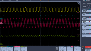

    After reading and consulting your explain and solution,we tested and set trigger to 5V falling edge, the Torque loop PI current limit is set to max (8A)and then we ran motor with 2 cases:
    Case 1: Motor ran in close loop at 85% max speed and the hardware lock current limit fault is set below
    And the result is the motor ran very well and it didn't stop:
    And then we continuously increased speed up to 90% of the max reference, motor suddenly stops and the result is below (FG, ground-to-phase-current and trigger 5V) and ONLY the fault "HARDWARE LOCK CURRENT LIMIT" is still triggered

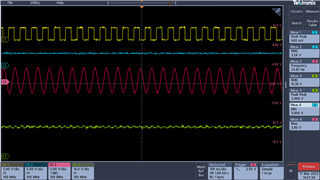

    Case 2: We disabled the hardware lock current limit fault:
    And speed reference is set to 95% of max value, and the result is motor ran very well and it didn't stop.

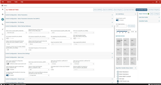

    Case 1: Disabled Hardware lock current limit (HW_LOCK_ILIMIT_MODE=1xx1b. Here is your result when speed motor is 85% and 95% of max speed respectively:
    And motor didn't stops at 95% speed, it was ok.
    Case 2: Enabled Hardware lock current limit
    We tested motor in order to check fault in 6 cases:
    -Case 2.1: HW_LOCK_ILIMIT_MODE=0000b
    Motor suddenly stops with nFault alarm

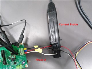

    Can you capture the GHA, GLA, and SHA so we can see if dead time is properly set? Bad dead time can cause high FET current.

  • I knew that FET is integrated in MCF8316A GUI, so I don't know how to measure GHA, GLA, SHA and capture for you

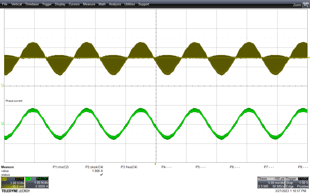

    Here is your results at 85% speed. The ground-to-phase current is red with peak phase is 3.8A
    And 95% speed below. The ground-to-phase current is red with peak phase is 5A
    When disabled "Hardware lock current limit mode", our motor only ran at up to 95% speed.

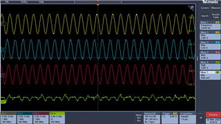

    Yesterday we continuously read the datasheet (about Integrated Current Sensoring) and ran motor.
    Can you monitor all three phase currents and check if there is any spike?
    Here are our latest results for discussion below:

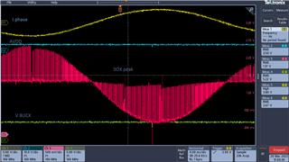

    ** Three phase current and SOX output pin (green) at 85% speed:
    There was any spike in three phase current. However, we suspected SOX output because our SOX's measurement is irregular (both in amplitude and frequency). And there was spike at SOX pin:
    This lead to the fact that at any given closed loop's time, SOX is interrupted and motor suddenly stops:
    So we have questions for you and your team:
    1. What is the correct output pin SOX's shape ?
    2. What is the cause of SOX's spike? How does it affect motor shutdown?
    3. What is the shunt resistor's position? I didn't see it in the MCF8316A datasheet and think it affects ISEN and SOX.
    4. What is supply power's value for Integrated current sensing? Is it from BUCK circuit ? And what is the max voltage of SOX output?
    Vuong N.T.
  • Vuong N.T.,
    I will get back to you on Monday.
    Vishnu
  • Hi Vuong,
    SOx output should look like below plot. Spikes in the current samples are triggering HW current limit. Did you enable Dynamic CSA gain? Did you set the current PI controller gains to zero? Setting them to zero will enable auto-calculation of current PI controller gains. Did you get the speed controller gains through MPET?

    We tested MCF8316A GUI with our motor for a long time. For the motor's parameters, it required a large phase current at high speed. When it ran in close-loop at high speed (over than 90%), the peak's phase current is 4A and up to 5A at 95% speed. There were spikes in SOX pinout, which led to HW_LOCK_ILIMIT_MODE (we set up to 8A) being active. We could find 2 main causes of our problems as follow:
    1. There were spikes in the power supply of the current Op-Amp
    (When the power supply is only active, the motor is not running, there had been spikes at the SOX pinout (red))
    2. The shunts are set in the low-side FETs, this led there were spikes (EMI).
    When the motor ran at 90% speed, PWM 10kHz is set and you can see it in SOX pinout.
    So we consider MCF8316AEVM never allows the motors that could run with the large phase current (over 5A). What do you think about this conclusion?
    We didn't know if your teams have tried motors that need the large phase current (over 5A) at high speed or not ? If yes, did you see any spike in the SOX pinout? And how did you solve this problem? Could you send me pictures about phase current when MCF8316A work with the value of peak phase current above 5A ?
    Vuong N.T.

  • Vuong,
    I'm not sure which current Op-Amp power supply and shunts you are referring to. Entire current sensing circuit is integrated inside the chip. We have spun motors with phase currents above 5A and haven't had any issues. I think this is a tuning issue. Did you try tuning the current PI controller gains manually?

    Hi Vuong,
    what is the setting of  OCP_LVL? 1: 10A and 0: 15A current protection in the FETs.
    What is the value of  HW_LOCK_ILIMIT at the FAULT_CONFIG1 register?
    These setting affect the high current protection shutdown.
    The noise at the SOx pin must be from the VM or ground noise and picked up by the scope. This spike noise might not be real between the SOx and AGND.
    1. OCP_LVL is set 10A, and we still with 15A but nothing new
    2. HW_LOCK_ILIMIT is max 8A

  • 1. When we ran the motor at over 95% speed, the motor suddenly stops even when the motor current is shorter than 8A (at about over 5A, it stopped). Therefore we didn't understand the details of the problems.
    Hi vuong,
    It seems the driver current sense amp detected the phase current was higher than 8A, but your measurement was about 5A. How did you measure the phase current of 5A? I am just pointing out the possibility of the error in your measurement.

  • How did you measure the phase current of 5A?
    To measure, I got the Current Probe (HCP8050).
    Besides, I also used another driver board (external FETs, IC driver, and MCU). Our motor spins well at any high speed). And I confirm with my BLDC motor, 95% max speed corresponds to about 5A phase current.
     Vuong N.T.
