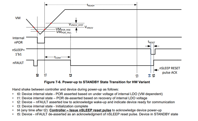

Customer concerns the initialization time requirement of DRV8243 (SPI version) after waken-up. Are there any requirements like this or recommendations?

Hi Joyce,
Page 23 of the datasheet shows the timings for the DRV8243-Q1. SPI communication is possible after t2.
