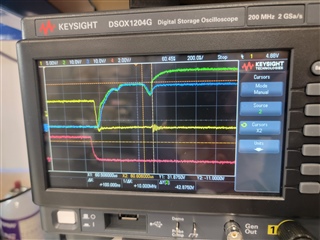

  • Doing the test above: IN the images I have attached
    Channel 1 (yellow): Nfault
    Channel 2 (green): VGLS
    Channel 3 (blue): VCP
    Channel 4 (red): Vdrain
    Nfault goes high at turn on of Vdrain but, goes back to 0V
    Figure 1: With VM at 15V, Apply Vdrain as a separate 15V supply
    Figure 2: With Vdrain at 15V, Apply VM as a separate 15V supply
  • Hi Michael,
    Could you provide me the schematic of your system?
    Thank you,
    Joshua

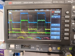

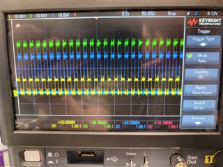

    Please use a good working board with Vdrain=30v
    Should I keep Vdrain and Vm seperate for this test, so Vm= 15V and Vdrain = 30V?  or have Vm = Vdrain = 30V ?
  • I ran the test above using a good board spinning at 100RPM with Vdrain at 30V and Vm at 15V
    Channel 1: (yellow): GLA
    Channel 2: (Green): GHA
    Channel 3: (Blue): SHA
    I moved the signals' vertical positions in case there was anything that's more obvious when not on top of eachother.
    Hi Michael,
    I see almost zero deadtime between GLX and GHx; this can cause damage to FETs and driver. Please capture at 200ns/div, at GLx going low and going high so we can see the deadtime values.
    Brian

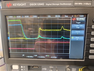

  • Re ran test zoomed in to 200ns/div
    Channel 4: (red): PWM U-L
    To show both PWM signals we use have a 500ns Deadtime between them:
    Channel 3: (Blue): PWM U-H

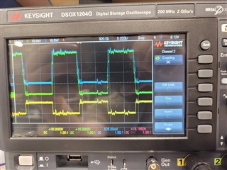

  • To show both PWM signals we use have a 500ns Deadtime between them:
    What are the PWM U-H and PWM U-L? Are they the pwm inputs to the driver corresponding to the output GHA and GLA? But then why U-H instead of A-H or A-L? If the 3 phase outputs are A, B, C, then the input should be A , B, C also, not U,V,W.
    Deadtime from GLA to GHA is about 400ns, and from GHA to  GLA is about 500ns, more than enough. What is the spec of the FETs?

  • I am slightly concerned by the GLA going low and GHA going high, the GHA signal seems to have leakage, though it is still 0V Vgs and the Gate is not driven above that until the 500ns specified
    Both GHA and SHA going H right after GLA going L, instead of 500ns late. This is not leakage issue but because the SHA was driven by the other phases (SHB and SHC) and when SHA float higher then this also cause GHA to get higher for VGS=0v as you have expected. It's normal.
    The FET spec is a very good device. Gate rise and fall times are ok. At this point I really don't know what caused the problem but suggest to check Boot Cap as  too big cap can cause damage to boot charging current source;  check VM for high spike voltage.
    Brian
