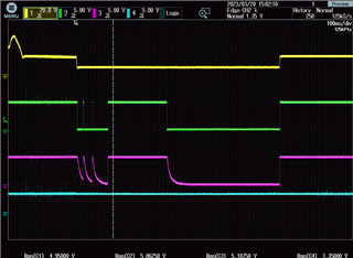

1ch:VM
2ch:nFAULT
3ch:AVDD
4ch:DVDD
Dear support team,
If VM underboltage occurs, nFAULT is driven LOW.
After that, nFAULT may return to HIGH even though it is below the recovery voltage.
What could be the reason for this?

Hi Morita san
Thank you for answering.
However, the UVLO2 recovery voltage should be at least 5.4V.
When I look at the oscilloscope, nFAULT is HIGH even at 4.95V.
Can nFAULT go HIGH even when VM voltage is below UVLO2?
Aoki
Hi Aoki san
Thank you for your question.
Yes, UVLO2 recovery voltage should be ~5.4V.
I see "4.95V" on the bottom of scope, I guess it may has small accuracy shift or measurement point voltage could be slightly different from VM(#28) pin and GND.
