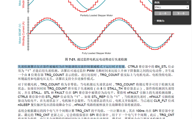

When driving the Nidec motor MSRPC20B09, coil disconnection, stall, and missing steps will happen. And as per the manual, "The stall detection algorithm is only valid if the device is programd to operate in smart tune ripple control decay mode. "(on page 36 of Chinese manual, could you please help check the correspond manual in English?)
However, during implementation, after setting to decay mode, the motor is unplugged and the chip (DRV8889) cannot detect.
Could you please help check this case? Thanks.

    You mentioned "And as per the manual, "The stall detection algorithm is only valid if the device is programmed to operate in smart tune ripple control decay mode. "(on page 36 of Chinese manual, could you please help check the correspond manual in English?)". Yes this is correct. Stall detection will work only in Smart Tune Ripple Control STRC decay mode (default decay mode). For all other decay modes stall detection will not work even if it was enabled.
    It seems like there's some confusion regarding stall and open load detect. These are two different features. Unplugging / disconnecting the stepper while active will trigger an OL (open load) fault if enabled. Stall may or may not be detected for this. Stall is detected when the motor is mechanically stalled while stall detection is properly setup  and the motor reaches a mechanical stop or a stall based on overload.

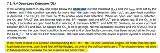

    Thank you for all the information. You mentioned current is 37.5% of the setting (to be confirmed). I'm assuming VREF = 3.3V which would translate to full scale current FSI of 1.5A x 0.375 = 0.5625A. There is a known issue with OL detection under the following conditions for this device. OL will not be detected when FSI < 0.96A and 1/64 or higher uSteps, FSI <= 1.5A and 1/128 & 1/256 uSteps. So for OL detect to work with the customers current setting we recommend to use 1/64 uSteps or lesser microsteps values 1/32, 1/16 etc. Also note the following conditions (below snippet from the datasheet) must be avoided when OL detection is enabled to avoid a false OL detection.
